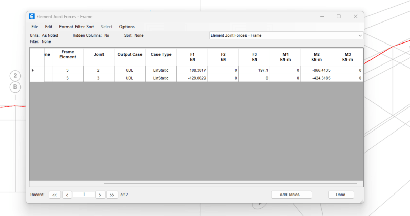

Results in ETABS:

Your Etabs result seems to indicate the axial force (F1) in the rafter changes over it’s length so either self weight is being considered or you have applied the load on the horizontal projection instead of perpendicular to the rafter local axis per your sketch.
The Etabs results you had in your screenshot are end forces in the global axis, your results are in the member local axis and also missing the fixed end reaction components.

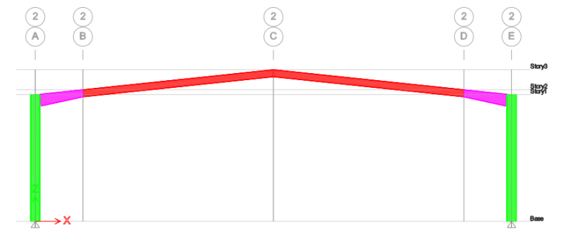

In ETABS, I am trying to replicate an Eaves Haunch. The way I have done this was to combine to seperate cross sections. One that tapers and one that is straight. Obviously, this creates a node joint between the members. So, my question is, will this combined member act as one single member, or is the joint (even though it is a rigid joint) not allow for the two seperate members to act as one single member? Because in the real world they weld a cut member to the bottom of the rafter to create the eaves haunch - not two seperate members.
Here is what it looks like:
Thanks again!
From an analysis perspective as long as you have not applied any releases/hinges to the member ends then you can insert nodes at will and the behvaiour will be that of a continuous member, to satisfy this for yourself create some very simple models one with a single bar element support to support and one with several bar elements support to support. I usually like to test this with a fixed-free cantilever and verify the tip deflections are the same.
Where you need to be careful is in design because the member length will typically default to be node to node so this will impact unbraced lengths for column/beam designs. Typically software like Etabs, Stadd, etc will allow you to manually define Lb for each axis of the member to override the computed node-to-node distance.

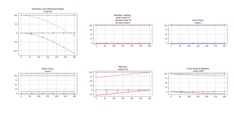

Here are my results for a simple fixed-free beam with a point load at the end (N6 and N8):
[pre]Displacements:
Node | Ux | Uy | Rz |
N1 | 0.0000E+00 | 0.0000E+00 | 0.0000E+00 |
N2 | 0.0000E+00 |-1.2874E-01 |-4.1379E-03 |
N3 | 0.0000E+00 |-4.7816E-01 |-7.3563E-03 |
N4 | 0.0000E+00 |-9.9310E-01 |-9.6552E-03 |
N5 | 0.0000E+00 |-1.6184E+00 |-1.1034E-02 |
N6 | 0.0000E+00 |-2.2989E+00 |-1.1494E-02 |
N7 | 0.0000E+00 | 0.0000E+00 | 0.0000E+00 |
N8 | 0.0000E+00 |-2.2989E+00 |-1.1494E-02 |

Here are my inputs:
Units are: inches for length and Kips for load
Sign Convention:
Positive loads are in the direction of the load axis
Positive moments are counter-clockwise
x+ to the right ➜
y+ is upward 🠕
Python:
# 5 Element Cantilever beam w/ Point Load
# and single element Cantilever beam w/ Point Load
loadcase = "D"
loadcombo = LoadCombo("S1", {"D": 1}, ["D"], False, "SLS")
# Nodes
N1 = R2Node(0, 0)
N2 = R2Node(60, 0)
N3 = R2Node(120, 0)
N4 = R2Node(180, 0)
N5 = R2Node(240, 0)
N6 = R2Node(300, 0)
N7 = R2Node(0, 100)
N8 = R2Node(300, 100)
# Node Restraints
N2.releaseAll()
N3.releaseAll()
N4.releaseAll()
N5.releaseAll()
N6.releaseAll()
N8.releaseAll()
# Node List
nodes = [N1, N2, N3, N4, N5, N6, N7, N8]
# Nodal Loads
N6.loads[loadcase] = [0, -10, 0]
N8.loads[loadcase] = [0, -10, 0]
# Materials
BeamMaterial = Material(29000)
# Sections
# W24x55
BeamSection = Section(16.2, 1350)
# Members
RF1 = R2Frame(N1, N2, BeamMaterial, BeamSection)
RF2 = R2Frame(N2, N3, BeamMaterial, BeamSection)
RF3 = R2Frame(N3, N4, BeamMaterial, BeamSection)
RF4 = R2Frame(N4, N5, BeamMaterial, BeamSection)
RF5 = R2Frame(N5, N6, BeamMaterial, BeamSection)
RF6 = R2Frame(N7, N8, BeamMaterial, BeamSection)
# Member List
members = [RF1, RF2, RF3, RF4, RF5, RF6]
in the typical FEM beams are "welded" together. The top of your column and the outbd end of the rafter have the same loads in them. making the rafter out of two beam elements would act as one (assuming they are "welded" together. Some FEMs allow you to release freedoms between elements, so you can create a pin joint by releasing the bending freedoms.
Tygra 1983 said:
I tried a single cantilever beam at an angle and got correct results. At first I thought the transformation matrix for the rotation would be the culprit, but now I don't think it is.
Try an L-shaped frame with vertical column and horizontal beam as the next step. Fix the frame at both supports to cut the DOfs down to three. That problem is small enough -- unlike your gable frame -- so that you could practically develop the manual solution and know exactly where your m file is going wrong.
Thanks guys for your help!
I am now considering second order effects. However, I'm not sure whether to calculate the factor by which you amplify the forces by, either by the wind load on the structure, the notional horizontal force, or the combination of both.
For a second-order analysis, superposition is limited. Thus, apply all load factors to all forces and then run the analysis.
Do you have a manual approximation that you can use to check that your program is working correctly? The B1, B2 method is great for this. If not, then you know by this point in the thread what I'd recommend. LOL!!
Hi 271828,
I am using the Direct Stiffness Method in Octave. Changing the subject slightly, I have modelled the eaves haunch for the gable by cutting it into five equal segments, so in reality it would have a staggered appearance (not a tapered one). The haunch is about 3m long, so, each segement is 0.6m. Obviously, the second moment of area decreases as you move towards the sharp end of the haunch, because the cross-section height decreases. In terms of results I am getting 4.51mm deflection from a force in ETABS, and 4.01mm using the same force using DSM in Octave. Do you think my method and results are good approximations?
Many thanks.
Tyra 1983 said:
.... 4.51mm deflection from a force in ETABS, and 4.01mm using the same force using DSM in Octave
Most stuff I work on 0.5mm is an insignificant amount. For your specific application you would need to judge that for yourself.
Seems like you modeled the tapered haunch the right way, I do the same approach.
