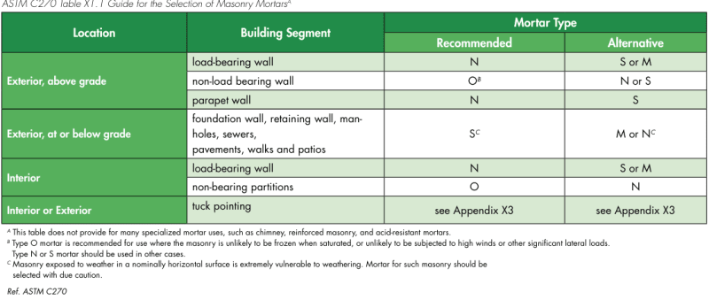

Typically for CMU I just specify wall assembly compressive strength f'm on my structural drawings, which determines permissible combinations of block strength and mortar per TMS602-22 specification table 2.

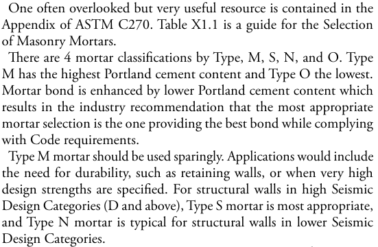

But ASTM C270 and other sources such as the article below indicate an inverse correlation between portland content and bond strength/moisture permeability, and recommend specifying type N in exterior walls if structural design allows for the decreased allowable compressive strength.
International Masonry Institute has been pushing structural engineers to specify higher f'm, switching from default 1500psi to 2000psi or 2500psi, which seems to run somewhat counter to the push for type N mortar.
Unfortunately, the article was meant to discuss reducing the embodied carbon of the mortar, but may have confused designers (as noted in your post). The most basic of all mortar recommendations is still Type S for strong or structural, and Type N for normal. So for reinforced masonry Type S should be used (TMS 402 lumps Type M and S together and since Type M is hard to work with, Type S is preferred). For masonry veneer Type N is appropriate. While you can use a Type N mortar for low seismic zones, I think most designers will stick to Type S. And as you say, using a higher f'm is a way to make masonry more economical. And if designers have been paying attention, a default of 1500 psi is no longer used and now a default f'm of 2000 psi is the proper strength. Using an f'm of 2500 psi can help push bars farther apart and maybe make the walls thinner. Engineers are being asked to balance strong and durable structures with low embodied carbon. That can be difficult, but making masonry more efficient does both.

I guess I don't see why you would design to a lower strength except to lower the cement content (i.e. lower embodied carbon). Flexural bond strength is actually higher with a Type S mortar (especially PCL mortars) than Type N and both Types N and S can provide for good water penetration resistance. I like that idea of designing for low carbon content, but I also don't want engineers to underutilize the full strength of masonry. To a certain extent, designers have already given up the potential of loadbearing masonry by using to brick veneer (and now thin brick veneer), and by recommending using lower strength CMU walls only pushes masonry into a more non-loadbearing usage. But that's just my take and I could be wrong.

masonrygeek, as stated in my post and multiple times in the article, the reason for specifying lower strength is "mortar with less cement content provides a better bond to the masonry unit, mitigating or eliminating moisture intrusion into the masonry system". Does not appear we're on the same page here. Different planet perhaps.

There are two properties here that shouldn't be interchanged - bond strength and extent of bond. A third type of strength - compressive strength - shouldn't be brought into the discussion because it doesn't necessarily correlate with the important properties of a wall assemblage. Bond strength is important when discussing the structural capacity of the wall. Extent of bond is important when discussing water penetration resistance. As noted in this PCA document on bond strength ( "Increased portland cement content of mortar generally provides increased bond strengths", so I think the article is misleading. It should have said "mortar with less cement MAY provide for a better EXTENT of bond than a higher strength mortar". However, the PCA document goes on to say, "Research has shown that the extent of bond and bond strength do not necessarily relate to one another". In other words, high bond strength doesn't mean that the wall won't leak, and vice versa. It's the compatibility between the unit and mortar that is most important. In general, use Type N mortars for brick veneer (to get good water penetration resistance) and Type S for reinforced block walls (for loadbearing strength). There will be times when Type N is fine for a block wall, but in most cases we are looking for higher f'm which is achieved with Type S, not Type N. And as Pham mentioned for any historical masonry, use low strength mortar so as not to damage the surrounding brick.
masonrygeek, yes I think we're on the same page now. I agree the article could have done a better job of distinguishing between bond strength and extent of bond. Do you agree type N provides superior extent of bond? Would you consider using type N where your design was less sensitive to f'm?
