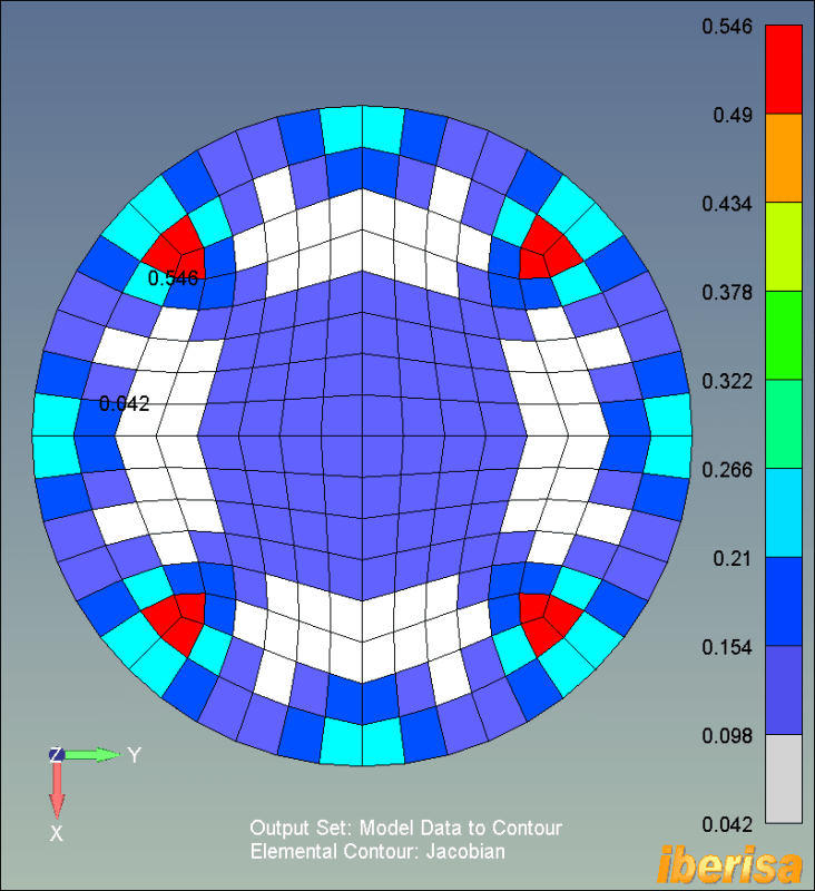

Dear Muruep00,
Also if you run FEMAP you can split the circular surface in four portions like the following picture:
Next simply use the MESHING TOOLBOX activating the MAPPED MESH option and you will arrive to the following 2-D quality mesh where the JACOBIAN check is well below of 0.6:
Best regards,
Blas.
PD
To learn more about 2-D meshing please visit my blog:
