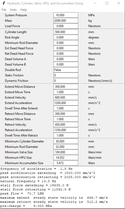

There are now simple formulas. I use a simulator. If necessary I can simulate the motion of two actuators running asynchronously but usually two are running in tandem so it is simple.
Peter Nachtwey
Delta Motion
IFPS Hall of Fame Member
