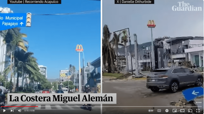

Kudos to whoever designed this McDonald's sign.

McDonalds is run on consistency - there is likely to be a sign installation section in their franchise manual and failing to meet the terms of that, which likely also includes inspection requirements (because they will have encountered short cut takers) means the franchise won't open until the deficiency is corrected.
