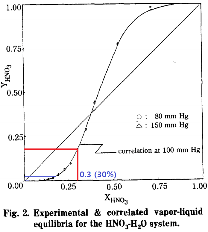

Nitric acid is thermally unstable, will easily decompose on heating to release NO2 and N2O4, which will go into water vapor overheads, so getting pure water overheads in a stripper column wont be possible I think.

Using a stripper column at this concentration will be energy intensive.
How about using an ion exchange resin meant for anion removal? This will remove the NO3- and SO4= ions and replace it it with Cl- ions.
If this feed liquid is solids laden, upstream particulate filtration will be required. Talk to an ion exchange resin supplier if interested.

Dear Georgeverghses
I would like to mention another.
The strong inorganic acids such like Nitric and Sulfuric Acids have very unique Vapor pressure curves.
Thanks to this reason, Stripping column can make pure water vapor!
See the feature of Vapor curve of Nitric Acid.
