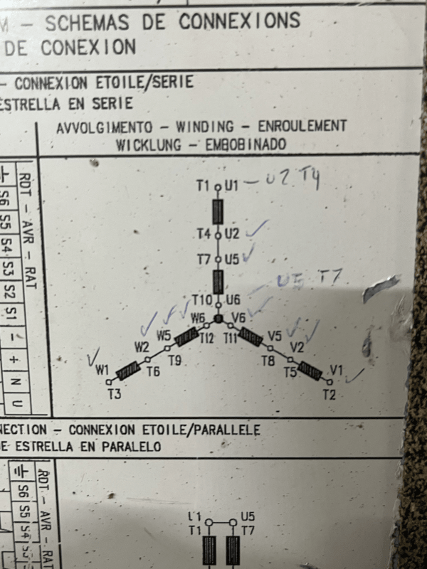

Thanks for everyone's comments. The generator is rated for 400 kW - not 60 kW. We have permission from the utility - not our first rodeo with them as we have implemented an SEL protection scheme with a variety of protections and sensing on the mains. Here is a pic of how the genny is connected.

Did you swap the connections in U phase? If you did, change it back as per nameplate.
Muthu
Good question on the ground - I will need to double check. RE nameplate, the handwritten notes are based on how the wiring was labeled by the folks that cleaned/reconditioned the unit.
Who marked up your nameplate? Was it the reconditioners? Are those old marks left over from a previous installation? I hate it when people mark up diagrams like this.
We asked our electrician to double check the wiring connections from the generator, AVR and the monitoring system (measures through CTs and VTs). He found that some of the wires on the generator connections (as seen in the pic) were duplicated.
If you are measuring 480 Volts line to line on all three phases, the connections are good, the numbers not so good.
Equal currents (200 Amps) on all three phases indicates that the connections are correct. (unless there is something that you have not told us).

There are strong indications that you are either over-excited or under-excited.
You may have a reversed connection in your control circuit or a reversed CT in your PF measuring circuit.
You may try connecting a voltmeter to the AVR output and check the field voltage before paralleling and after paralleling.
See if the excitation voltage increases or decreases when you parallel.
