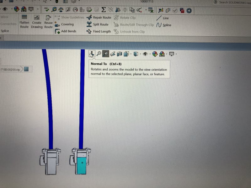

After I followed your directions, I got the view I needed, but it was very far from the face I selected.
The zoom-out popped out automatically...
I need to zoom in order to see clearly the view I want.....
CAD 2015
The picture below says everything, please read the explanation of the feature and let me know if it's possible to get rid of the zoom command:
