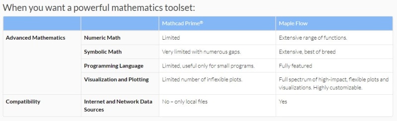

Since there were comments on Maple Flow in this thread, please let me know your questions. I am happy to share as much information as I can.
Samir Khan
Product Manager, Maple Flow
Hi Peter
We have an internal tool that migrates the content of Mathcad 13, 14 and 15 to Flow format ( hints at this). We may release this tool to the public in the future.
Mathcad and Flow are quite different tools with a different language and different feature set, so the automatic conversion isn't 100% (unless you're only doing what's supported by the migration tool). Certain Mathcad specific features aren't supported, like plots, inline programs, range variables. Some of these features may have an alternative manual path for implementation in Flow.
I can let you know more offline - please contact me at Maplesoft (please use the info email at the bottom of and mark it for my attention)
