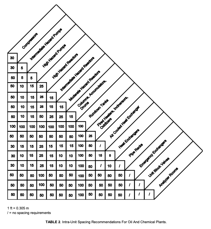

It's a longtime insurance recommendation dating back to Oil Insurance Association in the 1970s. OIA later became IRI (Industrial Risks Insurers) and then published their standards as GAP (Global Asset Protection. The GAP guidelines were more recently published by AIChE CCPS in their guidelines books.

Thank you, gents, for your constructive suggestions.
My problem is actually a request from one vendor to have a safety distance of 15 m for the Electrical Heater. Since the electrical heater is contactless i.e, process fluid is in a tube/pipeline surrounded by a heating element, then all is surrounded with insulation closed in the box, which is under slight N2 pressure.
There is no chance that gasses from external leaks (surrounding equipment), reach heating elements and generate explosions.
 https://files.engineering.com/getfile.aspx?folder=ea28861e-3f66-4332-b4ef-3b09923f916f&file=Oil_Insurance_Association.pdf
