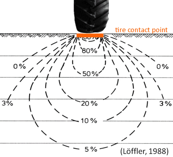

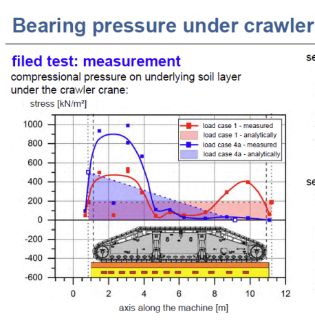

As EireChch mentions, the UK has formalized this as much as anyone. Look to some resources from the Temporary Works forum and the Deep Foundations Institute guide to working platforms. Practice in the US is much less formal. DFI also performed some research showing the following interesting soil pressure distribution below grade.
Moisture and drainage conditions are a huge factor, and probably were the cause of the incident you mentioned.
Further, plate load tests (s typically performed) have the issue of only measuring the response of a relatively small depth of influence. Track pressures often extend deeper.
It seems your civil department didn't adequately consider the situation (probably out of ignorance, this is a somewhat specialized area).
For mobile cranes and transport, long-term settlement is usually not a concern. The peak pressures don't exist statically that long.
