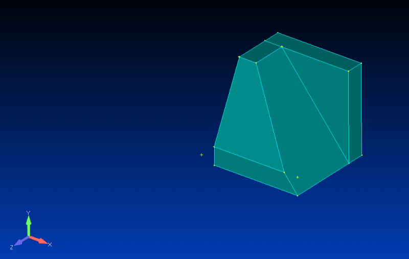

In the front view is one area that has 5 points and a second one with 4. This means the top view will either have an area with 5 points or be a line and will have an area that has 4 points or be a line.
In the side view the same will apply to the two surfaces. Since no area in the side view has a matching vertex count, those front view areas must be lines in the side view, which means those areas are perpendicular to the side view viewing direction. All the front view area points that do not form an area in the side view will be colinear in the side view.
Use the same method to identify areas in the side view to compare to the front.
Then try connecting the dots as shown, per the above method:
Try making some trimetric or isometric sketches and top. front, rear, LHS, RHS, and bottom views by starting with a brick shape and placing points on edges and faces and connecting them.
a cube cut by two inclined planes, one cutting the full width (creating the diagonal line on the side view and the horizontal line in the front view); the other cutting partially along the depth, leaving a full face at the rear, creating the diagonal line in the front view, and the larger portion of the side view.
