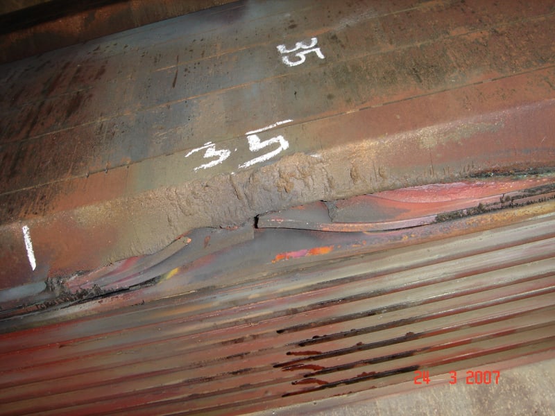

If the loss-of-field condition has persisted for some considerable or unknown length of time, the rotor should be inspected before operating again.

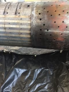

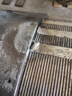

We did a rewind of a 15 MW two pole rotor whose winding and pole faces got cooked when it ran without excitation for a few minutes. The damper winding and a few wedges got melted and molten metal was sprayed around the stator end winding.

You are welcome, Mr Raghunath. The worst case I have seen is a 50 MW hydro generator completely destroyed (stator & rotor windings, stator core, DC exciter, bearings, turbine everything damaged beyond repair) due to asynchronous operation with field maintained for hours due to simultaneous governor & breakers malfunction and the operation & maintenance team just stood by and watched the destruction of machine from afar. Text book case of what IEEE defines as the most dangerous operating condition.

Rotor winding is subject to the same thermal limits as the stator. See below the rotor failure which occurred in multiple poles. I personally saw the shocking aftermath and submitted a failure analysis report to CEA. On my recommendation, they scrapped the entire unit and went for a new one. It was long time ago but I still remember the disaster.
