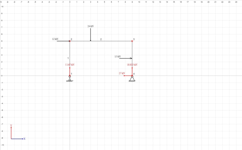

I am trying to solve a rigid frame that is supported by two pin supports. I am doing this using the unit load (or virtual work) method. To do this I am trying to create moment functions for each segement of the frame.
This is what my frame looks like:
I have replaced the pin support at node 1 to a roller (which is what my text book said to do).

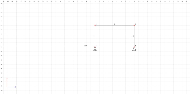

The virtual structure looks like the following:

From here, I have tried solving this using the double inegral procedure, but I am not getting the correct result. Am I on the right path here, or am I wqay off?

Re-read your post. So this is a redundant structure, pinned at 1 and 3. So you're using virtual work to final the horizontal reaction at 1 (the redundancy).
So yes, release the constraint (as you have) and apply a unit load. But you need to consider all three elements of the frame.

If I were just constructing the equation along member 2:3 the equation would be 5.1667*x - 24*(x-3). However, this is a frame with 2 dimensions, so I have added the dimension 'y'. For the virtual work procedure you solve the integral of the moment equation of the real structure 'M' multiplied by the virtual moment equation 'm'. Thus, 'M' equals 5.1667*x - 24*(x-3), and 'm' equals 1*y. The emphasis of my question here is I have I dont this correctly? Because I have an inegral with two independant variables which I have never tackled before till now.

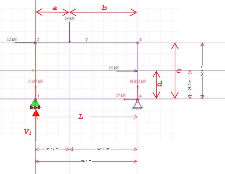

I believe the reaction at point 1 is correct. I checked it with scaled dimensions, assuming your sketch is drawn to some scale, and found it to be 5.19 kN ( compared to your 5.1667).
The equation for Member 2 is not correct. It should be M = V1*x - 24(x>3)(x-3). The term (x>3) is a Boolean expression; when x is less than 3, it is zero. If you don't include the boolean expression you won't get the right answer.
And by the way, it would be helpful if you put some dimensions on your sketch. We are good, but we're not mind readers.

I have resolved this problem! I wasn't considering the discontinuity at the 24 kN point of member 2-3. My moment equation was correct, it was just for the section of the member 3 < x < 9, Another moment equation of 5.1667x between 0 < x < 3 was required. I applied the same to member 3-4 and got the correct answer there too.

The dimensions were not known at first,so I checked for V1 using scaled dimensions. They are shown on the sketch below:
Dimensions a, b and L are 3, 6 and 9m respectively. We still don't know dimensions c and d, although it appears they are probably 5 and 2.5m.
rb1957 said:
what about the overturning moment ?
Overturning moment = 12*5+15*2.5 = 97.5kN-m
Stabilizing moment = 24*6 = 144kN-m
V1 = (144-97.5)/9 = 5.1667kN
ok, I'm a dumba$$ ... I took the ground reactions as reacting the vertical load ... but of course the near reaction would be higher ... like V1v = 16 and V4v = 8. and then v1m is like -10 and V4m +10 so all is right.
