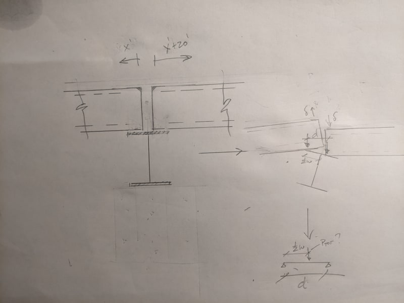

In a very typical scenario where we have hollowcore bearing each side of a wide flange beam, but with eccentric loading - the supposed compatibility torsion condition - where is the actual coupling happening that restrains rotation? Specifically during construction before any topping or reinforcing is in place?
The way I've justified it to myself ( see the sketch below ), is that under exaggerated differential rotation, assuming a fully rigid flange, the bearing(s) will shift until they are just points at tips of the cores. With the lighter section being lifted, and its bearing moving further to the outside, the couple is then restored. In field, I assume this all happens with bearing pressure distributions and minimal rotations at the shear tabs. It then remains to check the flange for yield with the point load acting thru the web - at least as an approximate method.
Any and all input appreciated.
As a followup question - if I bear my beam on an embedded bearing plate each end and weld it down (say with fully developed DBAs into concrete), creating some dregree of torsional restraint - would the warping stresses need additional investigation, or would you not consider it in practice?

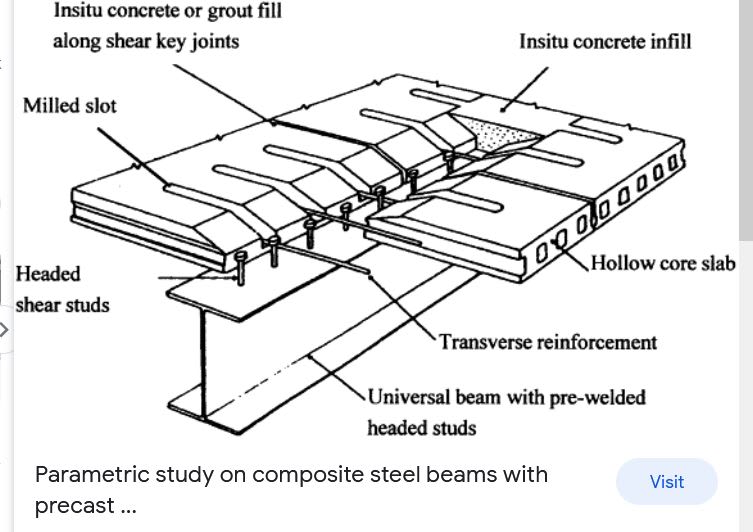

That is not an acceptable detail. Hollow core slabs should be tied across the steel beam to resist torsion and also to act as a horizontal diaphragm. I believe the usual detail is to leave a gap between the slab ends and use short lengths of reinforcement tying the slabs together. This means filling the cells for about 600mm each slab. If topping is used, it can help provide continuity.
BA - no argument there - I'm more concerned about temporary condition that exists in field when under construction.
For the temporary condition, shoring can be used as required.
Following is one possibility, but there may be easier ways of achieving the same.
BA - but what is the actual mechanism behind the torsional restraint? The detail above still does not eliminate the imbalanced loads coming in from the planks on either side of the web, it just prevents lateral displacement.

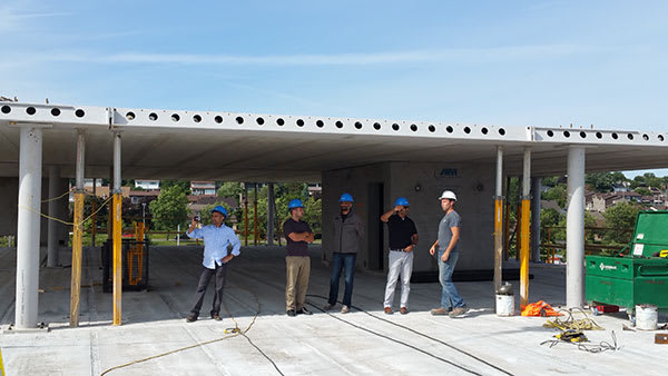

Hot damn, planks really do share load laterally...
Am I imagining things or is there some visible sag?
Sorry it’s a bit of an optical illusion. You’re seeing a delta beam running left to right, supporting planks that are spanning perpendicular. The shoring props at the ends are for the torsion induced by the planks on one side only. They put the props at the ends because the beams are cambered and need to be able to deflect.
This photo is just interesting to me because without those props, those guys would be standing in a very precarious position. I actually feel like plank collapses during construction is something I hear about with some regularity. The torsion concern is definitely legit, which is why I think delta beam enforces the use of these shoring props with their system. And delta beams being closed shapes are probably an order of magnitude more torsion-resistant than a typical WF beam.
Personally, I like the idea of explicitly designing for the torsion from worst case unbalanced loading, and carrying that through the entire load path. But as I’m sure Koot can attest to, the economics of that approach have probably kept it from being the standard of care for typical plank projects.
