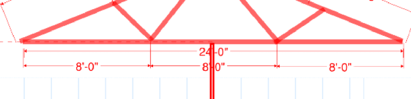

I have a client that is knocking out what was likely intended to be a non-load bearing internal wall. One story home, the wall runs perpendicular to the truss system (open W style, 24 ft span, with webs meeting the tension chords at 8'ft spacings, 2x4 members), an analysis shows that the truss was designed to span from exterior wall to exterior wall. The problem:

The bottom chord member is at about 104% capacity using the old snow load and no solar panels for the full exterior wall to exterior wall span.

I'd bet there wasn't a slip joint provided originally. If the trusses were truly designed to span between exterior walls for the original loading, and the wall in question isn't at a panel point, I'd be allowing removal regardless with the caveat that due to potential stress changes caused by the wall removal that cracking may appear in brittle ceiling finishes in other locations.
The wall being removed is at 12' from each exterior wall, center of the truss. The web truss members attach to the bottom chord at 8' from each end. The wall was not located at a point to buttress the truss correctly, if the wall is supporting the truss, it is inducing bending in the center 2x4. Thank you jayrod12!

Any suggestions for adding capacity for the tension member? Or design guides to go to for the extra 12% capacity?
If you must increase the capacity, I would assume it's only over the centre 8 feet? If so, I'd be looking at adding a second bottom chord with a series of nails that extend far enough beyond the panel point that the nails required for full tension transfer are provided beyond the truss plates. At a quick guess, you'd be looking at a 14-16 foot long member.
I concur with @jayrod. I think scabbing on another bottom chord with an appropriate nailing pattern should be everything you need to be sure of sufficient tension transfer.
I agree with jarod12 as well but with a concern: You may have analyzed the framing members of the truss but did you consider that the gang-nail plates connecting them have limits to their capacity as well?

Regarding the metal connector plates, the existing axial compression capacity of the truss chords is higher than the improved tension capacity, so I assumed that if the plates were designed to take the higher compression reactions, they could also transfer the increased tension loads. But no, I just included a note that said to visually inspect the existing connectors and if there was any sign of tear-out or damage to let me know and I would add capacity with OSB gussets.
I probably should look at that in retrospect to see if the assumption was right and to get a calc crunched out for my own peace of mind before the ceiling is closed up/ or a heavy snowstorm rolls along. Nailing patterns I am comfortable with, but I haven't yet tried to find resources on those toothed plates for capacity. Any resources/starting points appreciated!
Those plates are usually not intended to take compression. Compression is handled in bearing between truss members. Besides, the direction of the loading and the resulting edge distances are very different.
