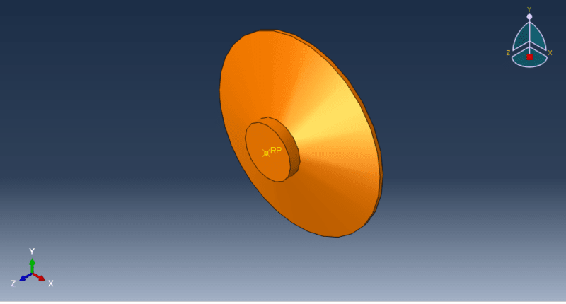

Yes, I have partitioned the surface into different layers so that I can assign a different stiffness value to each layer. However, I am now facing an issue with meshing. I need to assign mesh control as 'Hex-Sweep through medial axis.' I attempted to partition for meshing, but the orange color is still not changing to yellow. I have attach the images.
Please guide me.
Try separating the cylinder from the cone (using partitions, of course). You have to split the geometry into simple shapes to make it hex mesheable.

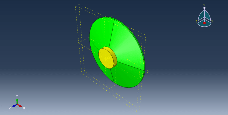

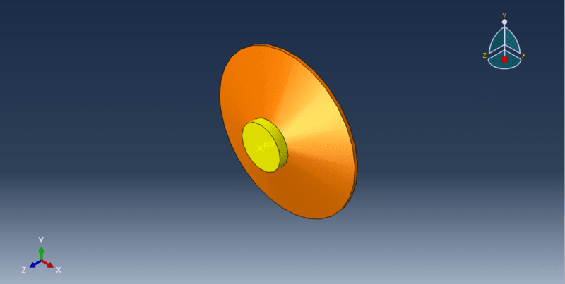

I tried but failed. I tried different partition method but still not getting the things. It worked only for the upper portion.
Now try splitting the cone in half in the perpendicular plane.
Will you please explain it little more?
Use the YZ or XZ plane (or its offset if the model is not aligned with global CSYS) for partition. To cut the cone in half.
Sir, For me it is coming like this
So it's hex mesheable, just with different techniques. You could cut the yellow cylinder in the same way to make it green and thus mesheable in the same way as the cone (with structured meshing).

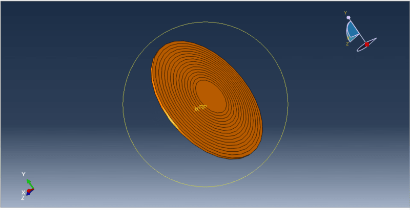

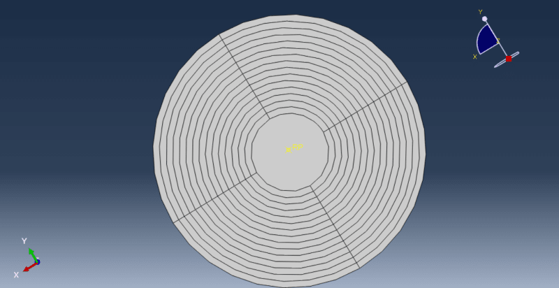

Thank you so much for your guidance, sir. It has helped me a lot. I have a few more doubts. I have partitioned the circular area into different circular regions so that I can assign different stiffness values, but for that, I have to select the nodes for each circular region. Can you guide me on how to do that? I tried by removing the selected face, but I can only do it for the first circular region.
