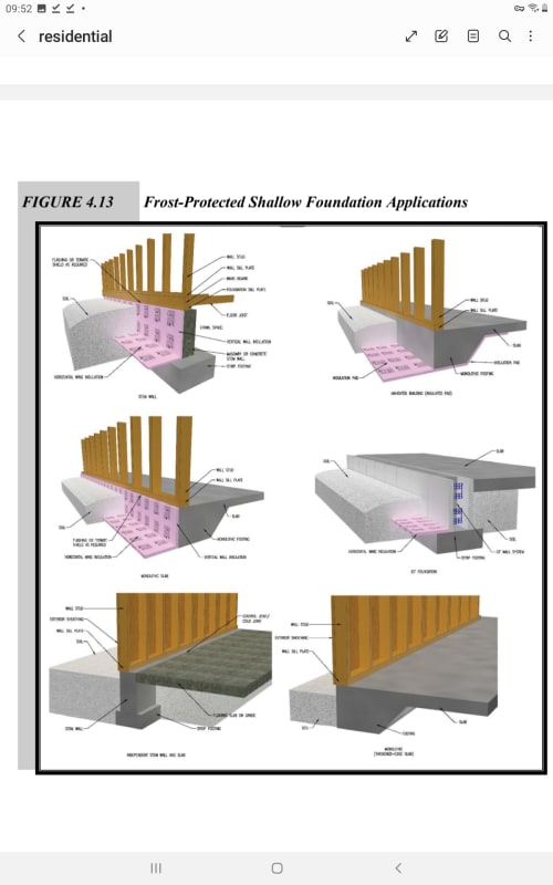

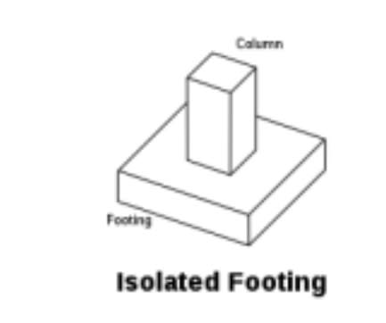

I see. What I am comparing with is an isolated shallow foundation. Heres an image attached. I take thst the beloew is not a pier foundation.
Yes, the Column, when made of concrete and cast above the footing has several names. A column, a pier or pedestal (USA), or plinth (UK).
If the column there is made of CMU blocks, that's my "pier block on pad", where pad = footing, where the footing is not usually large, often quite insufficient in many DIY constructions.
As you can see in the picture, there are several design styles that can all form a combination of slab on grade and pier/footing designs.
