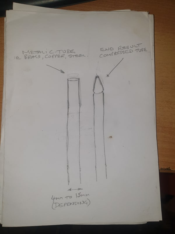

The goal is to do the opposite of what they are doing on the videos, basically shrinking the tube to create a spherical cone shape which would terminate the pipe
It is on a much smaller scale - between 4mm to 15mm diameter pipe (depending) with a wall thickness of roughly 0.5mm
Quantities would be in the thousands

Can you daw it out?
A true hemisphere or what exactly?

Also, posting a sketch of what you are trying to achieve never hurts, just so we're all on the same page.

See attached pic - very rough sketch
Doesnt matter about sealing the end as it needs a hole of around 0.5mm to 1.5mm depending (Its not a problem if too much material is gathered at the end, as this can be trimmed off or drilled out) The main objective is being able to shape the pipe)
Can you spin the tube or is this something to be done on the end of pipe?
A plug inside or outside with some glue would be far easier....
AAs you say, compressing / folding something round into a different shape is actually quite difficult as it can collapse, crumple or you just end up with too much metal or difficulty with holes in it.
Yes the tube/pipe needs to be one piece so it needs to spin if thats the method of being able to shape it. thinking about it, the length of it will hopefully not be a problem

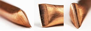

A crimped end would not work as it would need a true hemisphere to create the seal
This is not true in general. Military infrared sensors use vacuum Dewars with copper evacuation tubes (~0.2" diam) that are flat-crimped off and failure rate is negligible.

I’m not looking for a sealed off pipe. I need the end of the pipe to be in a tapered cone shape ideally with an opening/hole at the end. I just want to know if a process, or more importantly what machine and process is able to reduce/shrink a metallic pipe in such a way?
Some form of heating to increase the malleability is usually used.
The main problem is the section area of the tube is being reduced to nearly zero from a non-zero area.
