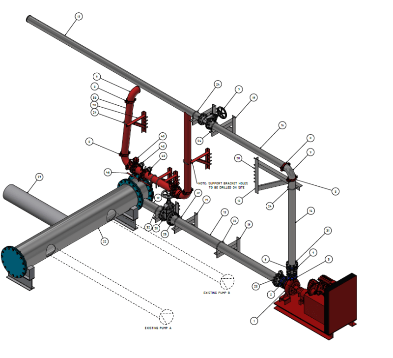

I am currectly designing a pipeline for a diesel powered fire pump and we are having some technicalities with the client.
The initital design had a straight suction which was perfect for the application.
However the client was denied permission to extent their boundary fence. Hence we are now forced to have a bend on the suction line.
My questions is how best can we put a dn200 90 degree elbow on the suction line without causing much harm to the pump.
Try to keep it a minimum of 2m (10 diameters) away from the pump flange. Use straight pipe between the bend and pump flange.
Got a sketch or picture so we can see what you're talking about?
Suction from what?
Pressures? flow rates, velocities all make a difference as to what is acceptable and what isn't / any issues.
But yes, max distance from the bend if you can or make it DN 300?
Thank you for your help.
Please note that i have added a sketch on the origional post.
To answer a your questions
1. The suction line is connected to an already existing manifold that is used by the client.
Nothing wrong with that layout at all.
If you really really want to do something then you could stick in a flow straightener in that inlet/suction leg, but >20D of straight pipe should be good enough to avoid any swirl.
Almost 5m is fine. A lot more than needed. You look good.
Thank you so much.
I will consider a flow straightener if we are not getting desirable discharge.
Whatever problems you may have, they won't be because of the inlet line bend.
What is the nominal diameter of the suction piping and what is inlet diameter of the centrifugal pump suction.??
Usually the suction piping is one size larger and there is a flat-side-up eccentric reducer at the pump..
But you have not given us enough information .... Where is your PID ?... Where is your pump datasheet/catalog cut ?
Do you have an isolation valve and check valve on the pump discharge ?..... Who knows...
....This is your very first piping layout, Isn't it ?
We can see everything but this on your CD cad model

Come on MJC, put your glasses on.
Its an 8" inlet and 6" outlet.
The reducer I can't see fair enough.
Looks like a NRV on the outlet and the isolation valve is a bit further down the system.
Think you're just being a bit grumpy today....
@MJCronin
Please note that i decided to share an isometric view because i find it easier to comprehend and explain sice its a picture.
The suction pipe is dn200 and the pump inlet is dn150 and there is an eccentirc reducer connected to an expansion joint that is connecte to the pump flange.
I have attached another isometric drawing of the initial design before we faced some technicalities with the client.
Everything was calculated and approved. There is a non return valve and a gate valve on the discharge pipeline.
