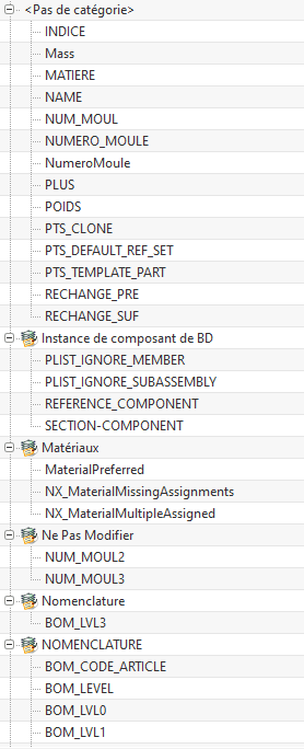

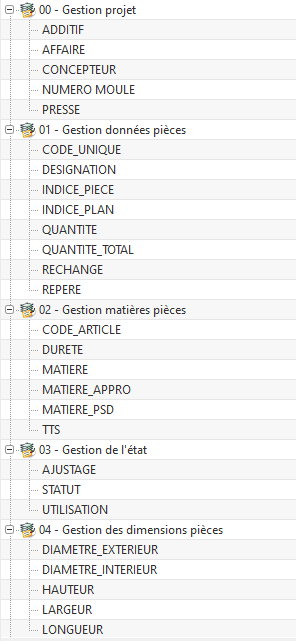

My problem is not quite opening a part it works correctly. I will try to explain myself differently.
My request is about updating part attributes (see image). Today the only way I have found to bring this back into line with my new attributes is to either redo the part or import it into a new file. I would like to know if there is another simpler method.
On the left the new ones, on the right the old ones
Thank you and good day
