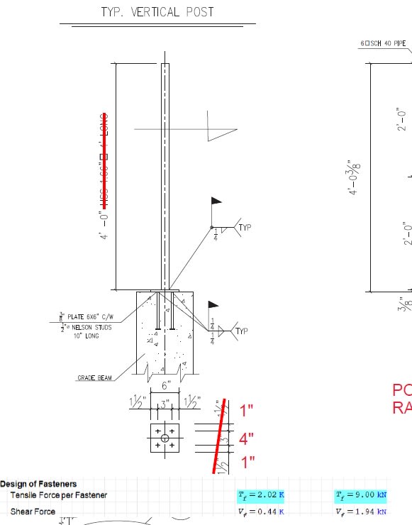

I have a project that has a couple of headed studs on a baseplate for a guard attachment. They are in proximity to eachother (4"). Does anyone have a spreadsheet that can be used to determine the tensile capacity. Or point me to something I can quickly use. Alternatively if someone can point me to a paper that addresses this. I've done an internet search and am saturated with the amount on non-useful information.

Do you have a dimensioned diagram of the stud joint and the loads being applied?
It's just conceptional at this point. Just adding prelim comments to what client wants... The guards are 4' high and spacing is at 5' with 1' cantilever... Posts need to be 1.90dia x 0.14 wall... The 10" embed is overkill, and eventually I'll need to confirm the design...and the base plate has to be 1/2".

I have an SMath program similar... I'll compare it. It's not the load distribution but the capacity of the headed studs. The client's proposal was to have 10" embedment for 1/2" studs and my quick calc indicated half that was more than adequate. I decided to do up an program.
Based on a quick analysis using the information that you provided above, I agree that half of the 10" embedment should be more than adequate. My calcs actually show 2.5" embedment being acceptable, although I wouldn't go that low.
