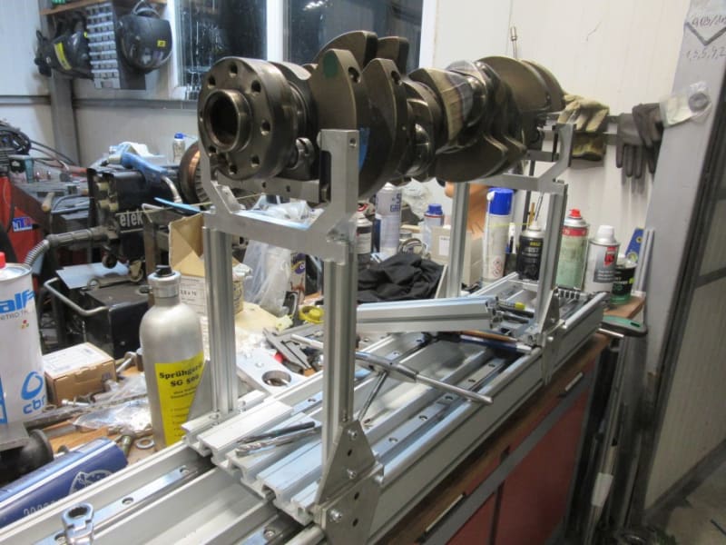

since I cannot find a local place to balance my crank I started to make a balancer stand using ADXL335 accelerometers and a QRD1114 looking at a reflective tape for triggering .
Finding the heavy spot using the acceleration plots is the easy bits .
I can't make the connection between acceleration and gr/cm imbalance .
Could somebody shed some light on that topic ?

Do you have any photo's of your set up, I like the idea.
That's what it looks like . Nothing fancy . For the drive I'll use a 9500 rpm angle grinder with some electronics to limit the rpm .
I suspect your fixture design is going to give you some trouble due to a lack of in-plane stiffness. If you test as-is you'll find this out.
What you really want is a LOT of stiffness in the vertical and longitudinal planes of the crank - this is why most commercial balancers use solid plate for the idler mounts. This setup may work at some level, but you're likely to lose a lot of sensitivity because your in-plane mount stiffness levels are not going to be very high using extrusions in bending like that.
Its better than nothing, its called use what you have. Is it located high for a reason, like larger diameter counter weights?
Very good construction, you put some work into it. Its nice to see some DIY things like this.
I'd like to balance the flywheel as well . And give me more room for the drive motor . Those ADXL335 acclelrometer don't have any crosstalk between the axes , so I don't expect to see anything from deflection in the Z axis . Might end up putting a steel wire and tensioner to reduce deflection .
NDimitrov have you made your own bob weight carriers or did you buy off-the-shelf? Good luck with your project! Seeing your results will be very interesting.
