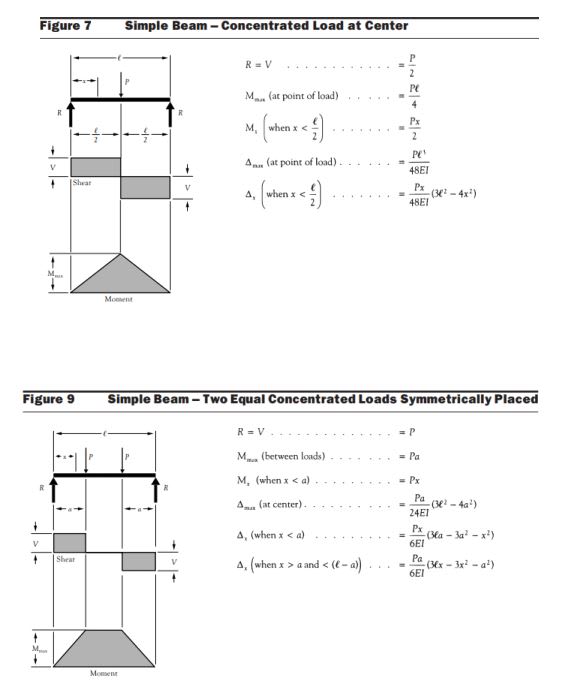

You could use superposition. Consider the case where B is zero, the deflection due to P and Q is x1. Now consider the case where P and Q are 0, what is the deflection due to a force at B, call it x2. Obviously for the combined case x1 =x2, hence you know the force at B.

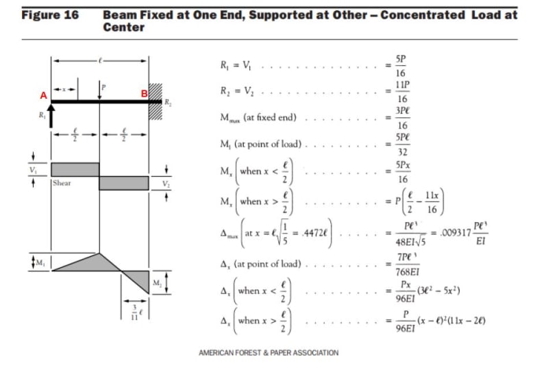

Owing to symmetry, if you cut the beam at B, you end up with a beam on two supports, one fixed and one simple (pinned). It's a statically determinate problem that's solved in many engineering books (remember: an engineer should never reinvent the wheel [wink]). With P midway of A and B the solution gives B/2=2.2 A, where B is the reaction in the original beam, and B/2 is of course the reaction in the cut beam So your result is correct! [medal]

If the beam is not rigid and is of uniform section properties, then it acts like a beam with one end fixed in rotation, by symmetry, at B and free to rotate at A or C. See Beam Fixed at One End, Supported at Other, diagram 13 on

"a beam on two supports, one fixed and one simple (pinned). It's a statically determinate problem" ... no, a propped cantilever is still indeterminate, but yes it is a common problem in most texts. But solving this using 3 moment equation or by unit force method is not "reinventing the wheel" ... it's applying tools in our toolbox.
Since P and Q are equal, the structure is symmetrical, which means that the slope is zero at point B as mentioned by prex. If P and Q were not equal, the structure would be indeterminate. Actually, the structure is indeterminate whether or not they are equal, but if they are not equal, the slope at B is not zero.
The reaction at the fixed end is 11P/16, which means that your reaction at B is 22P/16. Reactions at A and C are 5P/16.

A propped cantilever is a redundant structure ... since it has more reactions than the statically determinate simply supported beam.
The fact that solutions exist in texts is beside the point ... the problem is solved by bringing another equation into play ... the fact that the slope at the fixed end is zero.
This is an additional equation that solves the indeterminacy. I challenge anyone to solve the problem with only the equations of equilibrium (in this case there are two sum Forces and sum Moments).
What you're doing is using the unit force method, with the end moment as the redundancy.

You are quite right, rb1957, and I apologize. The structure is indeterminate because it cannot be solved by statics alone, whether or not P = Q.
This would serve as a check...
x=L/2, a=L/4
From Fig. 9, x1 = (Pa/6EI)(3Lx-3x^2-a^2) = 11PL^3/384EI
From Fig. 7, x2 = BL^3/48EI
If x1 = x2, then B = 1.375P, which is equal to 22P/16 as found above. okay
