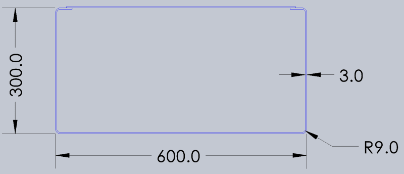

Hi All. We have to fabricate a 200 litre (50 gallon) fuel tank that will be underslung a trailer. This fuel is not for the truck, it is for a generator mounted on the trailer. Someone told me that it is better to fabricate it from alum sheet, because they said stainless steel sheet will crack. Can someone please validate this and explain why stainless steel sheet will crack but not aluminium sheet when used for a tank on a trailer?

Aluminum is generally superior. Thicker plate can be used which requires fewer bulkheads for reinforcement.
Stainless steel also has issues with road salts and dirt. It requires frequent washing to maintain it's "stainless" properties. High concentrations of salt on the surface can initiate stress corrosion cracking. Aluminum has similar sensitivities to dirt but is not as severely affected by salt.
If this is for a mobile application - and I don't care that the fuel is going to be used for a generator mounted on the trailer as opposed to for propulsion, it can still leak and catch fire and it can still be involved in motor vehicle collisions - your first step is to consult the relevant regulatory bodies in the place where you are going to be using this trailer, and establish what standards apply and what those standards have to say about it.

Are you forming the sheet into a rectangular tank with some sharp edges?
Aluminium is "softer" than Stl steel, I.e. has a lower yield, but doesn't work harden as much which is where you might get "cracking"
The radius of any bent shape will be crucial as well. Make it 10 to 15mm and you shouldn't have an issue with either.
Make it sharp edged or <5mm then you might.

As requested, I have added a typical cross section of the tank, see link below. Bottom section is bent from 5052-h32 bendable marine sheet. Internal radius is 9 mm. End plates are tig welded from outside and mig welded from inside. Will have baffles every +- 400 mm. Top sheet is only welded form outside.

I think this is more about welding than forming cracks. Welding SS is not easy and needs careful work, especially on thin sections.
But you really to talk to a metallurgist or welding engineer.
There is also mention of SCC which may be more prevalent in bent sections.
Ask the fab manager where exactly he sees cracking?
In the weld?
At the bent sections?
Somewhere else?
That will give you something to go on at least.
3mm is not very thick so will heat up and cool down rapidly and my be harder to weld without cracking as a thin sheet than maybe pipe or thicker plate
