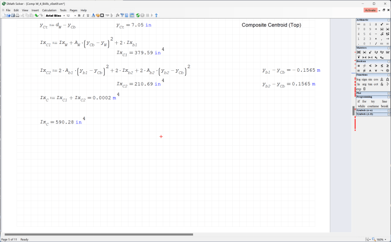

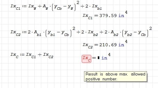

Any idea of why this error message comes up? The answer should be about 600 in^4. The last yb1 should be yb2.
Those are literal subscripts, aren't they? i.e., Ix.C vs. Ix[C? The gap for an index is larger than the gap for a literal.
Can you upload the sheet?
TTFN (ta ta for now)
1.58e8 + 87696568 = 2.45696568e8
That's above the limit for a signed 32-bit integer.
I don't know if that's important for this case, since SMath shouldn't be using signed 32-bit integers for what you show. Unless somewhere internally it's using them for the conversions between in^4 and mm^4.
Does SMath give you any control or visibility about the number types that it's using?

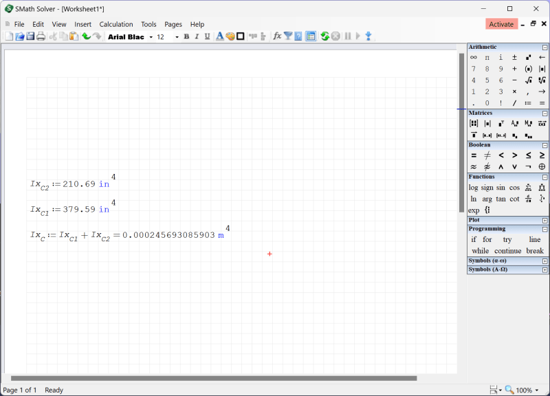

Thanks Mint... that could be the problem... drop the metric to m in lieu of mm... I'll try it.
It doesn't help... It's storing some huge numbers internally for what ever reason... dunno why... I removed all the metric I values... and I get the same message.
As I noted above, the numbers SMath is using, I assume internally, are extremely large. I don't know if it's possible to set a 'switch' of some sort. I couldn't find a 64 bit Windows version. It's a problem that's popped up a couple of times of late. I'll try reinstalling the program... see if that helps.

It's very interesting because just assigning the sum to anything screws up, but the sum by itself works fine as 590.279914418849000*'in^4

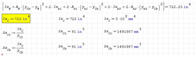

I broke the value up because it originally worked without the error... treating the total value... as a work around, I'll enter the value of the summation.
Oh, Oh, the number is different... something really strange... It's OK, I changed the beam size to a W16...
