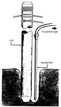

Instead of drilling, first, try jetting around existing timber piles. Maintain upward force on the piling as jetting is performed. The existing timber piles are probably "like-new" below the mudline.

I'm unfamiliar with "jetting". Does this disturb the stream bed?

High pressure water jetted into the ground next to the piles with a small metal pipe shoved into the ground as far as you can.
Sort of liquidises the soil for a short period of time so there may be a bit of sediment but then your pile comes out of the ground.
bridgeengineer2007 - Jetting 12"+ timber piling is performed more or less as described by LittleInch... just on a larger scale, using heavy equipment instead of manpower, and underwater:
