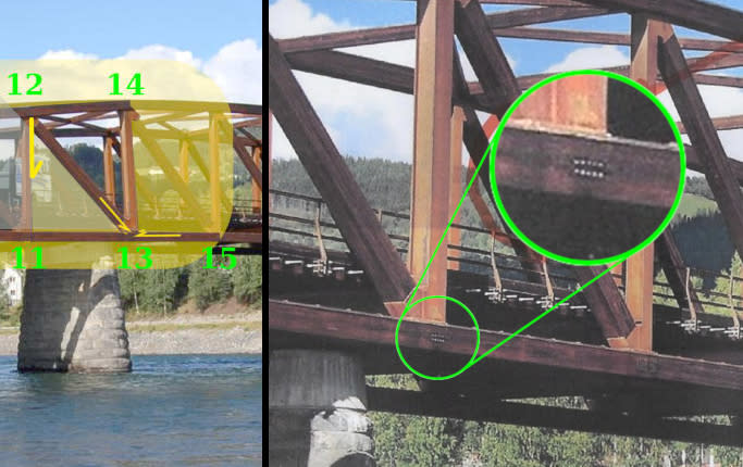

Note: In the reports, nodes are designated A for upstream (north truss) and B for downstream (south truss).

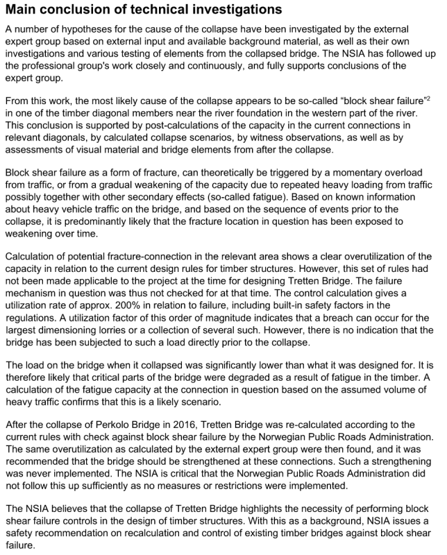

Summary below.
It seems they are grasping at straws. Since they can't pin it on a single known over-capacity load, they go for fatigue. In other words nominal traffic wore out the connections in ten years? That is equally unlikely.
The report expends too much effort on computer graphics espousing their theories as though that will lend credibility to their conclusory leaps. They open by stating they have considered many possible causes but list none of them.
Interestingly, a 100 ton load was moved across the bridge in April 2015. What happens to node 13 when a 100 ton load moves across the west span? That too is an easy lab test.

I must admit that your authorities tone and your contrary opinion started to have me agreeing with you before I had even looked at the linked source material.
After looking at it doesn't seem like your comments align well with their conclusions. Block shear failure is called out specifically. They haven't just scatter gun the shot at fatigue, they have specifically zeroed in on a particularly type of failure in a particular area. Some materials (timber) have a significant difference between their single event capacity and they 100,000 cycle capacity.
I don't see the obvious issue with their conclusion that you see.
**Feel free to come back at my fighting words. I can't say I'm an expert in the failure analysis of timber bridges!
Yes, I agree that fatigue is likely involved. "Nominal loading over ten years" defines fatigue loading quite well. But material degradation is also likely a factor, along with design error.
Thanks for weighing in. I have no doubt that block shear occurred as a result of fatigue. My question is why?
We generally have a very robust discipline that ensures our structures don't fail catastrophically or if they do, they give ample warning. To pass off vague assertions as an engineering review is an insult to intelligence and no amount of computer graphics will assuage that. It lacks inquisitive tenacity and is just plain lazy.

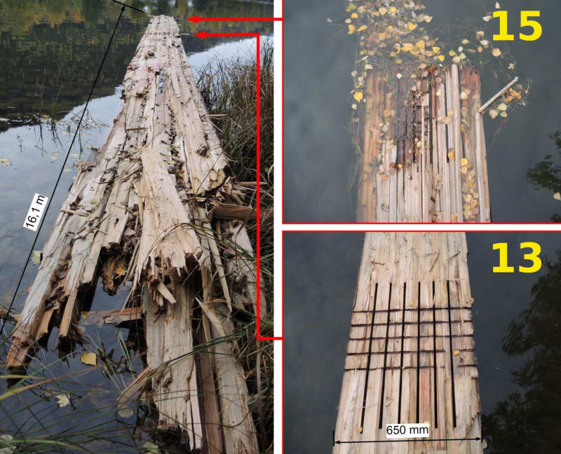

In this case, there is an engineering flaw that will lead to fatigue of the identified connections at nodes 14 and 15. A load on the west span will flex the lower chord at node 13 while simultaneously driving the pin connection horizontally into it, the perfect conditions to split the chord. At the same time, movement of the steel U frame at 13 will cause rotation at the 14/15 connections. (Note: The U frame is not fixed to the support or the road deck so it's free to slide between them. The diagonal transfers its horizontal load to the lower chord through the U frame and thus, the pins.)
I don't see much in the report to build my theory other than a photo of the split lower chord. It's length spans the distance from node 11 to 15 and the split is clean and even from 13 to 15. The report suggests this split was caused by downward movement at 15 but I don't find that compelling.

From Appendix B,
page 51 said:
Fra inspeksjon av skadde brudeler har trolig første brudd skjedd i tilknytning til en vertikal mellom knutepunktene 15 og 16 (T15-16). På disse vertikalene hadde både overgurten og undergurten en skjøt, ...
From inspection of damaged bridge parts, the first break probably occurred in connection with a vertical between nodes 15 and 16 (T15-16). On these verticals, both the upper girth and the lower girth had a joint, ...
What is it about the damaged bridge parts that flags this as the first break. It is one thing to suspect this node as problematic, and I agree it could be, but another to posit this as the initiation site. To me this is a leap.

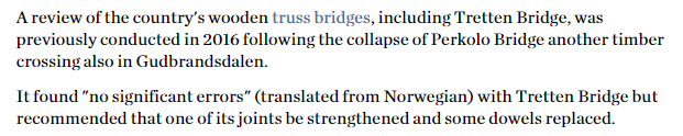

The excerpt below suggests they need to skip the site review and send out the design drawings to some PHd types to study for several years. This seems like a case where the connection looks good until it doesn't.
I think that it should be remembered that the most important goal of the analysis of this bridge failure is to eliminate any blame for any of the entities involved. That can take a good bit of time and effort--it's not as easy as it looks!
spsalso
The 2016 review finding of "No Significant Errors" is most likely with respect to the code of construction.
Brad805 (Structural) copied the reports conclusions which indicate the current code (in 2016) would have required stronger joints.
So how does the finger pointing go when the engineer uses a code of construction specified by the AHJ and it turns out to be wrong?
