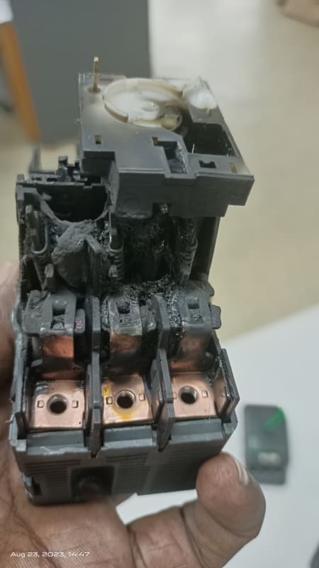

Today one of the Schneider make MPCB (GV2L04) rated for 0.63A burnt inside our panel. This circuit breaker was feeding to a 150W single phase (230V) motor.
We have used Tesys T LTMR for DOL starter.
When the incident happened, it was raining heavily. We suspect that the water leaked into the motor which cause current surge in Breaker and burnt. But why was it not tripped? All I understand is that the current surge is more than what the above mentioned circuit breaker can handle. So overcurrent leads to heating the components and burnt. But Please advise if there is any other causes which might have caused the issue apart from faulty/defective MPCB.
We need to develop a root cause analysis. So need to give realistic technical reason. Thanks.

Has this breaker tripped previously? It carries an AC-3 rating which means it's good for 100k cycles at the motor rated current (0.63amp) but the mag trip is 8 amps which means the cycle durability can be much lower at the breakers 8 amp instantaneous trip rating. The breaker may have been damaged in by previous trips.
Have you witnessed the contacts? Can you share pictures?
No discoloration at the lugs, this wasn't caused by loose connection. The failure was certainly at the contacts in the breaker.
With that said, it appears components were blown off the breaker so there was some energy behind this. What is your potential fault current? Is it greater than 100kA? Should you consider current limiting fuses or an isolation transformer? Is there a DC component to your power?
That looks like an internal flash-over.
You didn't say if the motor was damaged.

That is for a short downstream of the breaker.​
If water or moisture, possibly combined with dirt or dust buildup inside the breaker, there may have been an internal flashover ahead of the breaker contacts.
Either way, the arc may persist until enough material has been burned away to clear the arc.
You said that the breaker did not trip.
How can you tell.
There doesn't seem to be enough left to tell if the breaker tripped.

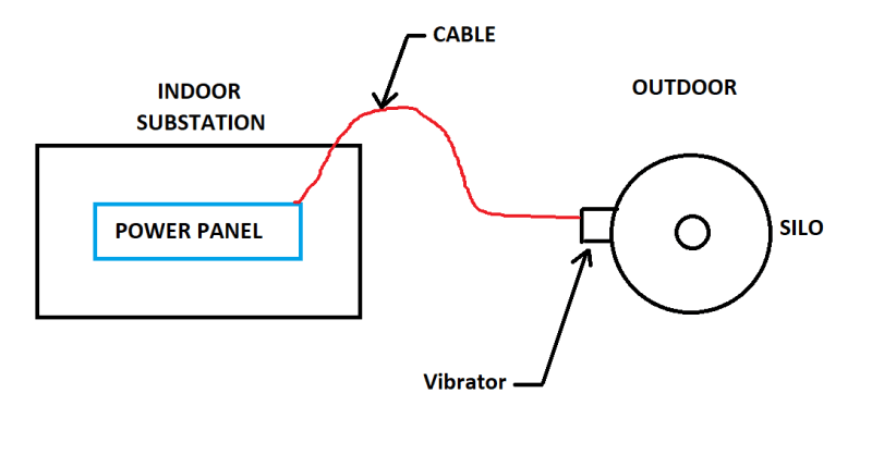

The load connected in this circuit is a Silo Vibrator (Datasheet attached).
The load is installed outdoor and the Power Panel where the DOL circuit is installed in indoor substation building.
The actual load current shown in the datasheet is 2.3Amps. But the circuit breaker selected is 0.63A. I know this is This is a mistake.
I suspect there was a overcurrent. But please explain how this could cause a such a burning MPCB?

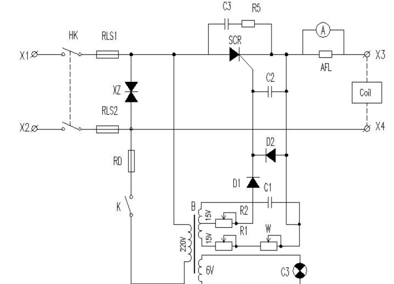

Actually the load is not a typical motor. It's an electrical magnetic Vibrator Vibrator video Link
The Breaker and the load equipment are brand new.
Was the vibrator damaged?
Is the Zener, XZ damaged?
If the breaker tripped, an inductive kick from transformer B could light up an arc across the breaker contacts if Zener XZ failed to clip the kick transients.
A high voltage transient on the supply may have overcome the Zener and initiated the internal arc in the breaker.
At this point we are guessing, but it may be well to check the Zener XZ.
