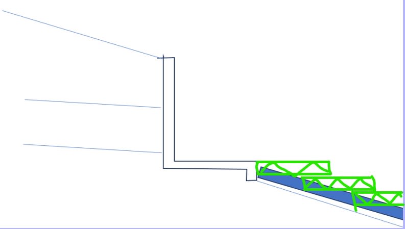

Hi all,
See below image. Is there a standard connection detail for connecting a reno mattress (riprap apron) to a concrete headwall.
The ground downstream of the outlet is sloping and I dont want any movement of the reno mattress.
Have considered fixing U bars into wingwall base and U bars at top of mattress and interlocking but not sure if its the best detail
Also considering posts into the ground and tying mattress into them.
instead of (or in addition to) connecting to the structure, anchor using either metal posts or using a gabion anchor trench / cutoff wall.
I would think that you would want a seal to prevent water from entering under the 'mattress', but I'm not sure.
cvg - thanks have also considered that. Need to do some excavation work so burying a 1m deep gabion basket and tying into that is not much more work. Although,I feel a U bar connection is the easiest and quickest but doesnt seem to be much on that type of connection online. I will give Maceferri a call on Monday.

Your sketch looks pretty steep. Have you done a calculation to assess flow velocity vs scour velocity of bed material at the end of the gabion basket
If there is a big drop i would propose the following (alternatively you could concrete the gap at teh top):
Providing an attachment of the wire baskets to the slab/cutoff wall would be difficult, since the wires are fairly small. Possibly, you could embed welded wire reinforcement into the slab and extend it out where it would lay under the gabion mattress.

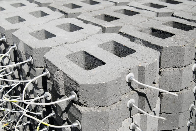

Another option to consider is using precast articulated block mattresses, instead.
They have cables, which are easier to connect to the CIP concrete.

Thank all, I spoke to someone at Maceferri and they recommended a very simple fixation of hammering in 40mm dia L bars through the mattress, to 1m below the matress. The mattress is 0.5m thick so bar length is 1.5m. One row at top of mattress at 300mm c/c and one row at mindpoint of 4.8m long mattress
I was expecting something more but apparently its a common method to fix them in slopes. (The actual slope isnt as steep as I have shown, its maybe 15 deg. )

We like to pin to the outlet of the culvert so if there is erosion or settlement it stays connected to the outlet. We have used stainless or galvanized eyes anchored into the concrete at the top of cut-off wall or bottom of wingwall, etc... We also spec out high survivability Filter Fabric under the gabions. Note, I have seen the aftermath of the failure of soil anchoring pins and the outlet of the culvert was almost lost.
It actually looks like we are going back to connection to head wall as the riverbed is a lot softer than anticipated.
The proposal is the include a rectangular plate with some holes within the mattress. The holes are to receive bolts chemically fixed to headwall
