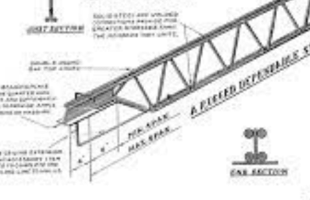

Kootk, in this image that you showed, both web and chords are made of Round Bars?
I hadn't seen it yet.
KootK's post is of an old and antiquated joist style. Rounds for chords was rare, and isn't done at all now. It's all double angle chords with round bar webs for K-series. In the past, some companies used light gauge hat channels for chords. Lots of things have been attempted. A lot of them failed - either commercially or physically.

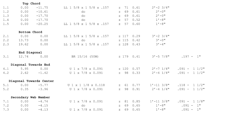

Efficient design depends on pounds of steel. Any large fabricator that is tooled up with all the equipment, and design tools will not use round bar much anymore for the reasons you cite. Many large fabricators order their steel in rolls and custom bend exactly what they want. That reduces waste a ton, and gives them endless flexibility. Below is a recent design calc sheet from one. They spank the other competitors using their level of automation. Old school fabricators or small shops will use round bar due to ease of fabrication with low cost equipment. I could setup a die in my own shop to bend out webs using round bar.
