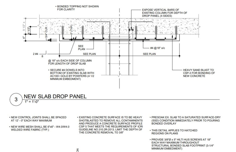

Yeah the "add a drop panel" always looked iffy to me, not that there are good options, given the relative lack of research and working to fix an existing deficiency. Usually you're dealing with a slab that's too thin to omit the deflection checks, and that's where problems start - the slab is too thin, so depth of rebar is critical, and then punching shear wasn't checked correctly in the initial design. (or it's never checked, like Harbour Cay). How do you fix that?
To me, I really wonder about shoring because you need a fair area to add the concrete for the drop panel and you're chopping away at the column concrete to thread bars through. If you aren't shoring, you're asking the vertical bars to take 100% of the load in place, and the bars are unsupported for what, 8"? I suppose buckling or yielding isn't that likely, but development length of the column vertical reinforcement? Splices?
Plus development length (of the added bars) and all that epoxy being done properly has always seemed pretty optimistic to me. And can you get a U shaped bar through the column anyway? And I'm not clear the approach is trying to use shear friction to bypass the deficient design, or what the exact design approach is. Is it supposed to be some kind of load-sharing between the original and the added? Or is the drop panel supposed to take it all? Also, if they overdid the reinforcing in the column that would complicate getting the bars through in the first place. And then there's the question about the floor concrete strength versus the column concrete strength.... I've noticed that a few times as well. I think the column concrete is supposed to be no more than 40% stronger than the floor concrete but it seems that little fine print information gets missed by some. (ACI 318-63 talks about it in section 917. CTS had that issue on floors 1-4)
I've not designed or sealed a retrofit drop panel (partly because I've never gotten into a spot where I needed one, and multistory concrete repair isn't really a main component of my work/experience either), but I did have a project where some ding-dong used EnerCalc for footing design and (because they didn't read the manual) got the bar location wrong so it had punching shear issues "from below". You really can't add a drop panel above a footing because it conflicts with the parking in the basement and naturally they'd poured the slab by that time as well. Why anyone would bother with EnerCalc for a footing when they can just pull them from CRSI, well, that's another discussion, but not using CRSI created the problem when they used EnerCalc wrong.
As a reference detail for the "add a drop panel", I've attached something I found (for Clarity, it's from Champlain Towers South, work that was never performed, or, perhaps, never finalized and sealed). It seems likely something similar was done (and successfully, I suppose) on Dolphin Towers. The original design of CTS in at least a few areas had too much column reinforcing (several beyond 4% others beyond 8%). (Just like Harbour Cay). I would check for that here as well.
(Note there's no "existing hatch" on the column)
