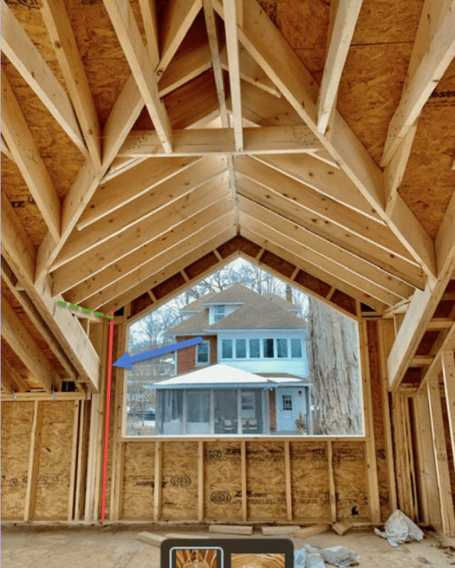

A client wants to use triangular windows in a dormer and sent the photos below as an example. The problem is, the ridge isn't direclty supported. Traditional framing rules are that you either need to support the ridge or tie the rafters (if it can't spread, it can't come down). However, I want to at least poke a litter deeper, as we all know, wood structures are fairly redundant. So what is holding this example up:

[li]In the framing photo there looks to be a lot of nails in the single tie at the 2nd set of dormer roof rafters. Maybe this is an attempt at some sort of tie at that end.[/li]

The internal bracing shown in the photos doesn't look to me like it would be sufficiently stiff to guarantee load transfer into the dormer walls. Which themselves are partially cantilevered above the roof diaphragm.. Man the more you think about it the more there is going on.

As small as the dormer walls are and as short as the span is, I might be temped to design a fixed base on the studs with some extra blocking along the doubled rafter. Though my preference would be to get the architect to give me some walls from floor to dormer bearing so I can pin them to roof diaphragm and resist thrust through bending in the studs. Would be a tough sell, though.
Perhaps if I design the red column to be able to take moment fixed at blue arrow, I would stamp it. You have to make sure the double plate (dashed green) can span and able to take the thrust force from the dormer though. Maybe specify LVL instead and detail connections on both sides.
FWIW -> architect accepted some steel rods as rafter ties.
