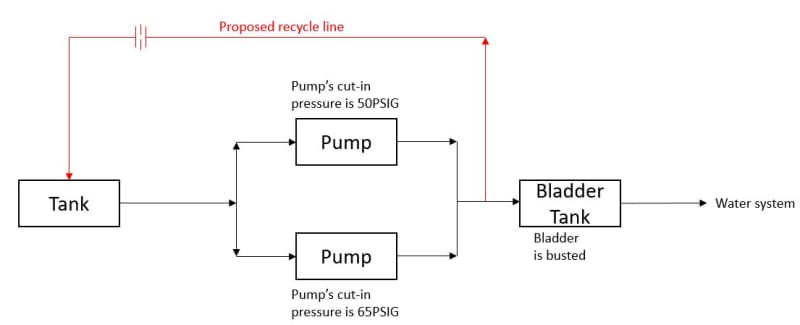

Currently, two centrifugal pumps in parallel run in lead and lag to move water from the tank to the water system. The discharge of the pump feeds a bladder tank that's supposed to keep the pressure constant and minimize the pump from turning on/off constantly. However, the bladder is busted again and we want to add a recycle line from the discharge of the pumps to the tank to allow for continuous pump run. How would adding an orifice plate on this recycle line effect the pump curve? Would it help with our problem?
It doesn't affect the pump curve per as a you have a flow of usually 20 to 30%, but that flow then can't be used to go forward so all the energy for that flow is wasted.
An ARV is much better as it allows recirculation flow when there is no or low forward flow, but closes when you need all the flow.

We could though do with a sketch of the system.

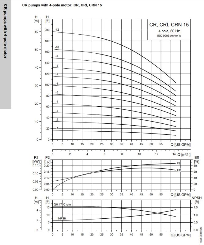

You would need to size the orifice to be at a flow which is less than 65 psi on your pump curve for one unit.
No idea what this is unless you post the pump curve but might be quite a lot of flow.
How did the system turn the second pump off? What pressure is it set to revert to one pump?
I assume the lead pump will be continuously running so the orifice would be sized for the manufacturer's recommended minimum flow at corresponding discharge pressure of pump at the pump curve differential head corresponding to the recommended minimum flow. The lag pump could still cut in at 50 psi I assume but it would cut out significantly before minimum flow is reached so that both pumps would not operate at minimum flow simultaneously. With a recyce line like this you are going to loose some capacity to the end users per what flow is being recycled but with two pumps available capacity you still may have more than enough flow.

I can't see why you would want to run pumps constantly. Can you explain? Just turn them off when flow is below minimum. Usually a high pressure switch does that job. Where is it?
Apparently you are blowing out the bladder, possibly by the pressure spike of one or the second pump quickly turning on, or by the pumps discharging at too high a pressure. Why not just solve that problem? Again, the high pressure switch could be used for that too.
It appears that you have a bladder tank with bladder that is not designed for the dead head pressure of the pump or just on the borderline so it keeps on busting. This appears to be the case since the pump start is at 65 psig so the maximum pressure output of pump must be close to 100 psig at zero flow (when bladder is fully compressed).

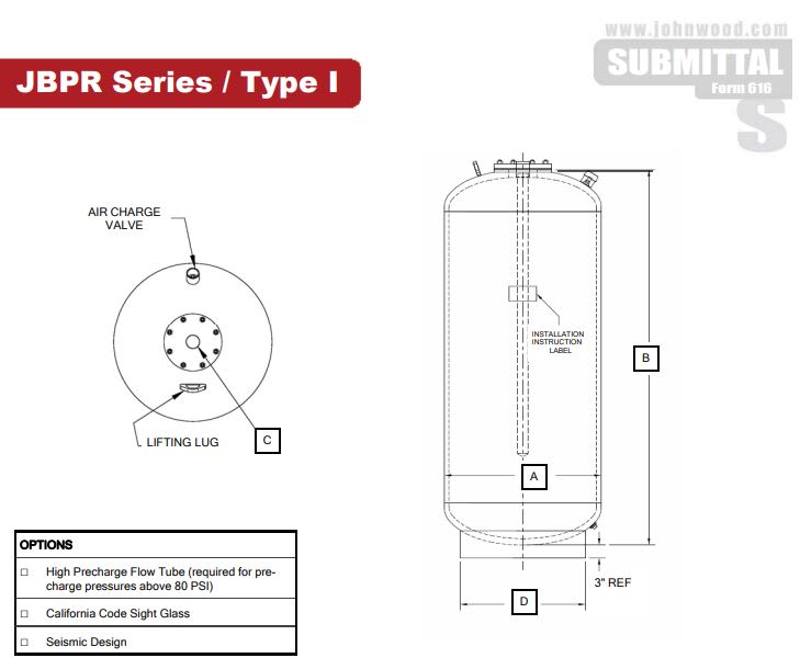

Ideally the best solution would be to replace tank with a new tank of higher design pressure. The attached has tanks available in pressures up to 300 psig rated pressure. The tank should be sized to give a minimum run time of pump once it cuts in. I believe that most pump motor manufacturer's recommend about 5+ minutes minimum run time and no more than 5 starts/stops per hour. So when the pump cuts in the vessel bladder size should be such that it will take 5 minutes to compress from where it is at at cut in pressure to the discharge pressure. Without a recycle line a high pressure switch shutdown should shut off the pump when it reaches recommended minimum flow.
The orifice recycle line is a cheaper option to replacing the bladder tank but your pumps will run continuously causing them to have more maintenance issues and reduce overall life, and use up a lot more energy and cost to opearate.
 https://files.engineering.com/getfile.aspx?folder=0bf55ee1-bed3-47da-9760-5d02cd4168b3&file=FXA-35-800L-HP-Submittal.pdf
We don't know the duty cycle or the pumps. They may run 90% of the time in which case s recirculation line is acceptable. They may run 10% of the time in which case the recirculation line is not acceptable.
I'm asking why recirculation is even needed. A recirculation line only reduces operating pressure and useful flow and increases energy and maintenance costs. Nothing acceptable about that. Its just an emergency hack to keep it running. Recirculation is for mixing, temperature control, or a temporary means to get to operating condition. Without further explanation from OP, it seems to be the wrong way to attack this problem. 5 billion systems just like this run just fine without recirculation, using only low pressure start and high pressure cut out.
[highlight #EF2929]@LittleInch
How does the system sense when you need more or less flow? Is that based on tank level? Or? The demand for flow will fluctuate throughout the day and the PIT downstream of the pumps will regulate the pump status.
How did the system turn the second pump off? What pressure is it set to revert to one pump? Second pump will turn off once system pressure rises above its cut-in pressure so 50PSIG.

You are blowing out the bladder, possibly by the pressure spike of one or the second pump quickly turning on - looking at the trends, we do not surpass the 125psig design pressure
Emergency hack to keep it running - exactly what we need. Any suggestions?
There are multiple operating curves for Q vs head. Which one is yours?

4) My guess from the data so far is that your pump is the -10 series on the curve above - can you confirm?
5) You do realise wrt the bladder that those tanks work on the bladder being filled with water and the air is the cushion on the outside? The instructions says to pump up the tank to about 2-3psi below the pump start set point - i.e. about 62 psi. Is that what you have done? If not then what you have done is inflate the bladder well beyond it's design size as the initial pre charge from the factory is only 12 psi. Did anyone actually read the installation manual?
Here for anyone interested in how these tanks work note item 2 under operating / maintenance instructions.

But in answer to your first question, yes it could work, but I think the flow would need to be quite high through the orifice plate to get the pressure below the cut off point for the pump assuming that at times you have no or very little flow and your pump is the -10 or even the -9 version. So maybe 40-50% of your max flow is going no where, but you're paying for it. Also your motor and pump are then running continuously so wearing out faster and your second pump will probably start operating a lot more as a lot of pump 1s flow is going straight back to the tank.
If you're serious about doing this long term, then look into ARV (Automatic recirculation valves) which vary the return flow depending on outlet flow and shut off automatically. But if there is low or no flow for long periods you are basically just throwing energy (money) away.
