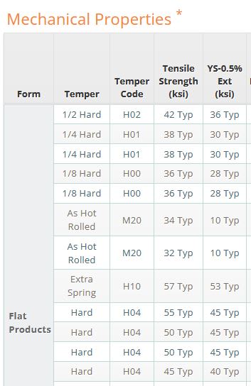

So using that, I need less than a tonne.

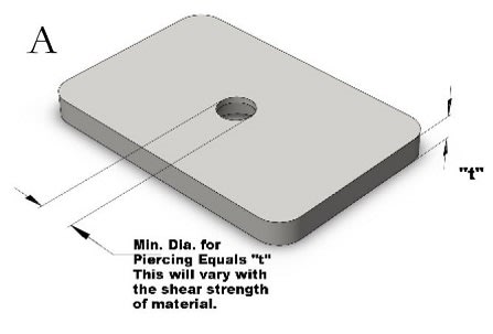

Stamping these is a lot harder than you think, holes that are as deep (or deeper) than the diameter pose very special problems.

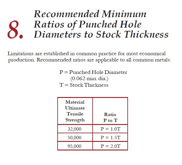

Mat'l thickness 3mm
Hole dia. 5mm
(see attached Dayton Rogers Redbook for more info)

Most textbooks in Manufacturing Processes will give the equation provided in the link above.
If you don't have Shear Stress values, an alternative formula is F = (0.7)*T*L*(UTS) where UTS is Ultimate Tensile Strength (T = thickness, L = perimeter length of shear line). Mind your units in the calculations.
The critical issue for quality holes is clearance values between the punch and die. In none of your descriptions did I see any mention of the process quality requirements.
