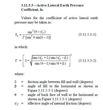

Below is the soil pressure coefficient calculation out of the AASHTO spec. You should be able to enter Beta as a negative angle corresponding to your slope into the equations, and get a decent approximation. The soil pressure is bound to be really low, though.
Structurally, you could design it for a level backfill condition, and it would be plenty conservative.
For the sliding stability, it would seem that would be conservative, also, but I'm not completely sure of that.

Beta is the angle of the backfill from horizontal, in this case, it will be around -30, if your sketch is correct.
Gamma, the friction angle between the wall and backfill can be conservatively approximated as half of phi, the angle of internal friction of the soil.
The angle of the back face of the wall looks to be vertical. If so, theta = 90 degrees.

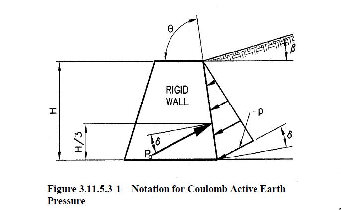

Sorry I didn't get this up earlier, but here ya go. I hope it helps.
I dont think this picture describes my scenario.
What you have on the picture is an full soil profile behind the wall. I dont have this.

You're not likely to find a diagram for your scenario. It's not common to build a retaining wall to hold back a diminishing slope. What is the purpose of backfilling this?
If this were my design, I'd likely just assume that the backfill is level behind the wall(even though it's not) for lateral loading purposes. When checking overturning, though, I would only utilize the actual weight of material on the heel.

WinelandV makes some good points. I would use a loose to medium unit weight for the soil, a relatively low soil friction angle, and a Coulomb equation for the active earth pressure coefficient of downward sloping soil behind the wall.
