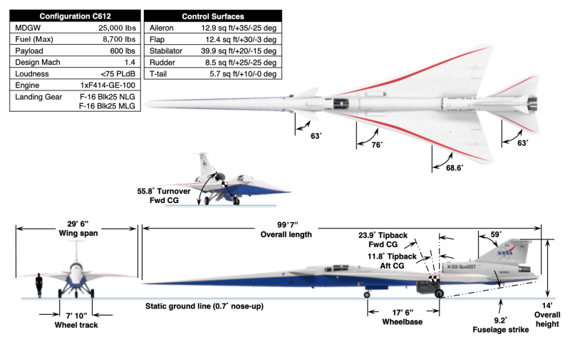

My gosh, better not stop short in that plane.
Stopping short is not too concerning, look at the location of the cg, if anything a bit too close to the rear landing gear. Like Wil said, over-rotation on takeoff would be a bigger concern...but at least it has canards, which if actively controlled, could help prevent that.
I might have thrown the 3 view into autocad, since no one seems to list the wing area (!~640 ft^2).
Its got quite a low wing loading (35 lb/ft^2), which makes sense since with an aspect ration ~ 1.36, 9 degrees of rotation isn't going to generate that much lift (looks like Delta Cl .25 before flaps & and whatever contribution the foreplanes generate). It will be interesting to see what the flight handling is reported as
Edit: didn't double check scaling in autocad, minor numbers correction.
PS the tail height is listed as 14 ft, seems oddly round for a number measured from the ground, is this a hanger height limit somewhere?
