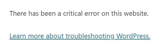

There seems to be a link failure on JStephan's link.
Can you re-post a link to the article?
Thanks...
I think that part of the website is just temporarily down, check it later.

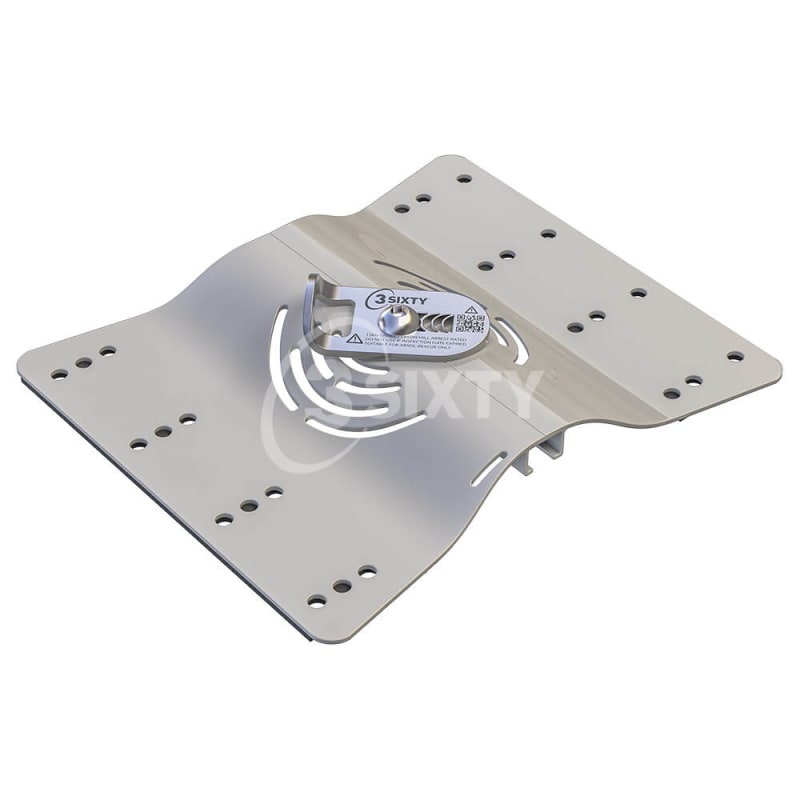

I've seen some super dodgy anchors that claim to offer 15kN resistance, when fixed into 0.55mm steel long run roofing sheet.
They claim to have done a bunch of testing but wont show any evidence.
Still, they find engineers around here to sign off on them.
stainless steel plates rivetted to the roof sheet with about 8 rivets. I would never tie off to one of those.
Could you elaborate on your engineering concerns? Or are you simply uncomfortable with the idea, uncomfortable with heights, or uncomfortable trusting somebody else's engineering in this case.
I ask because I can see how it can be made to work suitably. I say this as an engineer and also a user of fall arrest equipment.
This only needs 8 rivets into 0.42mm sheet.
Neat... do they have one for 22KN?

Bones - Yikes. I hate the stiffness of that "base plate". Not sure if it is helping to absorb energy or hurting by causing serious second order forces on the fasteners.
-Mac
Absolutely helping.
When it comes to catching falls it is 90% about energy absorption. You can readily exceed 22kN with an 80kg mass if you don't have suitable energy absorption. With suitable absorption under 3kN is realistic. That said, the plate that I linked has built in energy absorption without adding much to the moment applied to the plate.
(Due to an attachment getting caught I have taken a fall onto a fixed line without and absorber observing what broke would indicate the forces exceeded 4kN and could have been higher had energy not been absorb in the breakage. 4kN+ might not sound like much but my body was on the other end of that 4kN!)
A quick perusal of what they offer and the answer seems to be no. All 15kN as they are made for the Australian market, I guess gravity is weaker down here. [ponder]
