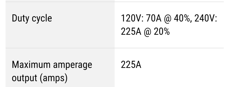

Welcome to the world of power tool ratings. Vacuums and air compressor power ratings are based off the locked rotor amps.
Here is a duty cycle description for a Harbor Freight welder of similar output from a much larger unit and at 6x the cost.
https://www.harborfreight.com/stick-225-inverter-w...
Another giveaway is that the welder "weld all day at 2.5mm". That would imply a 100% duty cycle st 50 amps. Then again, when stick welding one spends a fraction of the time welding vs changing electrodes and prepping for the next. In that case the 100% duty cycle is likely much closer to 25amps.
