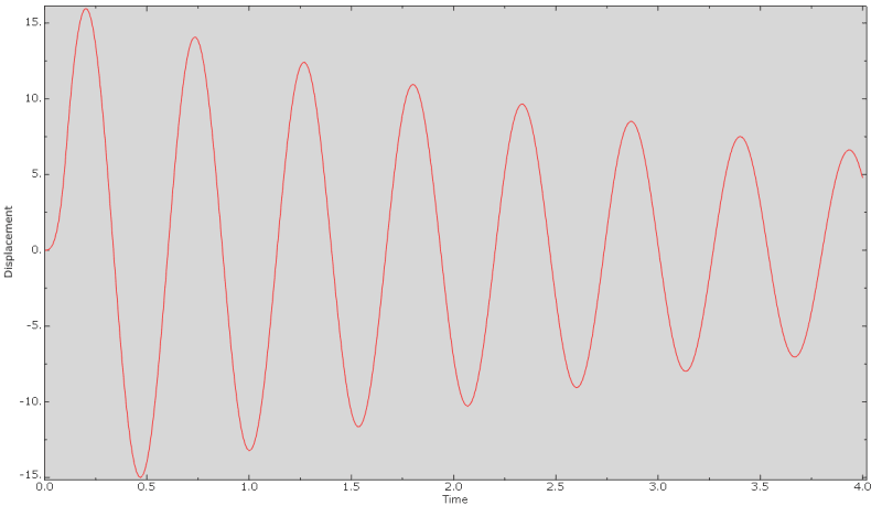

Hello everyone!
I'm working on a simple benchmark problem involving a spring-mass-damper system (for which I can get an analytical solution) modeled like this in Abaqus:
Currently, the damper is represented as modal damping with critical damping fraction for the natural frequency defined in the analysis step. The procedure is (transient) modal dynamics with a step time of 4 s and time increment of 0.1 s, utilizing a single mode shape from the preceding eigenfrequency extraction step. As you can see, the mass is simply a cube connected with a spring via a rigid body constraint. The spring is fixed at the other end.
A tensile load is applied to the opposite side of the cube and the following amplitude is used for it:

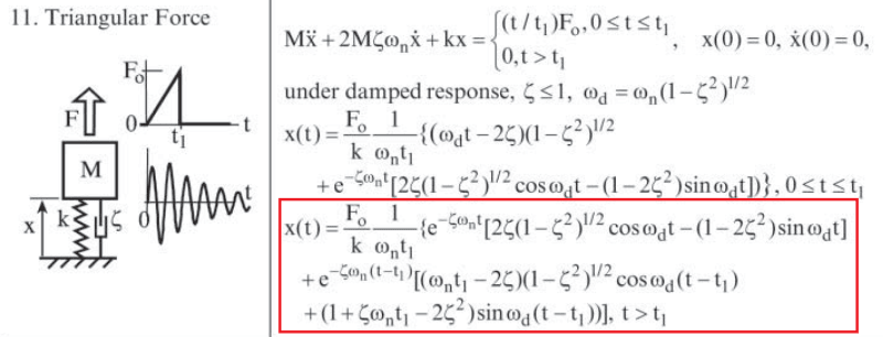

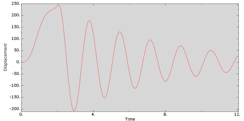

The problem is that I don't get any vibrations in results. Just a response (displacement of one of the nodes of the cube) equivalent to the applied amplitude and with the final displacement close to 0 (according to the analytical solution it shouldn't be zero for t=4 s):
I would expect a response like this (from the Blevins' book):
Am I missing something here?

I was testing different k and m values. I got not so bad results for the last data set shared here (with f_n = 0.59 Hz): 138.35 mm from the simulation vs 106.76 mm from the analytical calculations. But for other values of k I don't get any agreement. Here's the current information:
1. Input:
- mass: 54.286 kg
- stiffness: 7.5398 N/mm
- natural frequency: 1.8757 Hz
2. Damping:
ξ = 0.02
The book defines it as "dimensionless damping factor also called the damping ratio and fraction of critical damping". I define it as "modal damping" and specify the fraction of critical damping so it should be correct.

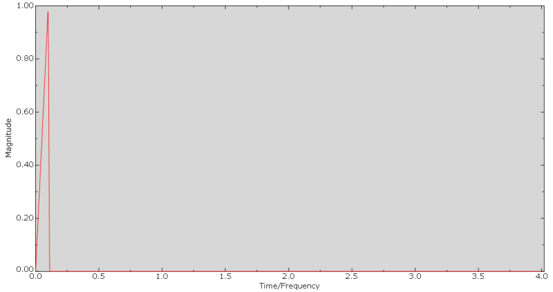

3. Load:
F= 200 N
The book doesn't provide any recommendations, it only describes the load as "triangular force". It's just one of the cases from a table (like in Roark's).
I changed the amplitude to make the impulse shorter. Currently the amplitude is:
t A
0 0
0.1 1
0.11 0
4 0
4. Timestep:
t_i = 0.01 s since (1/1.8757)/10 = 0.0533 s

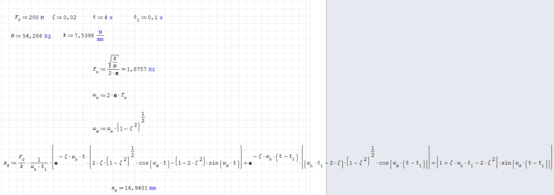

5. Analytical results:
Currently, there's no agreement. For t=4 s I get 4.77 mm from the simulation and 16.94 mm from the analytical calculations. Here's the response from the analysis:
The formula from the book:
And my calculations (should be correct since I'm using SMath):
Any ideas what can be wrong?

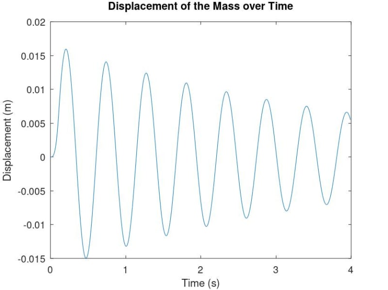

You've now shortened the ramp, so it is more like a pulse excitation. At t=0.1 the velocity should be 200/2/54*.1 m/s, so the simple harmonic motion amplitude ie the first peak should be .2 m/s/12 rad/s=16mm ish, so check your analytical for that
Cheers
Greg Locock

which agrees with your plot pretty well. Your unreadable smath is probably wrong
Cheers
Greg Locock

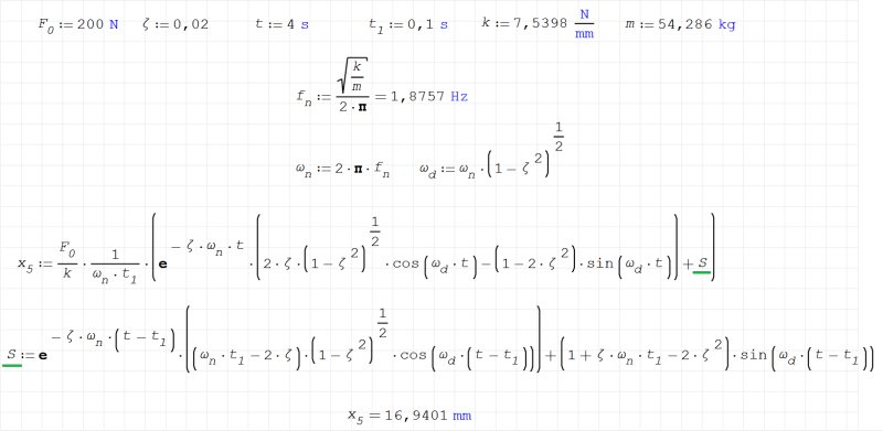

Thank you very much for this numerical solution. Did you have to make many corrections to what ChatGPT generated?
I would like to correct my analytical solution anyway. You are right that it was too hard to read. This one should be much better:
I checked the formula a few times but maybe I missed some mistake that you will notice. Or the equation in the book is incorrect... I couldn't get agreement with equations for harmonic loading of beams from this book as well.
A few edits that were quicker to do directly, the RK section is unchanged. It got the eta calculation wrong, just ignored the conversion to cv.

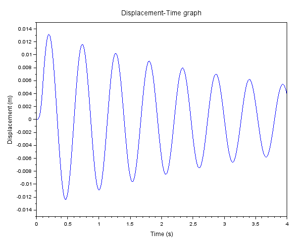

I don't have access to Matlab so I asked ChatGPT to generate a similar code for SciLab. Here's what I got:

The resulting plot is almost the same but with some difference in values:
I wonder what caused it.
Right, now it looks like your plot and the value for t = 4 s is 4.8 mm (previously it was 4.68 mm) while the simulation result is 4.77 mm. Close enough.
I still wonder if this analytical solution utilizing the formula from the Blevin's book ("Formulas for Dynamics, Acoustics and Vibration") can be fixed and provide correct results. I've got no idea what can be wrong with it.
