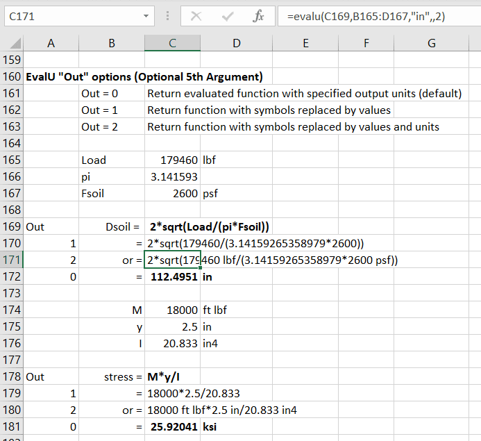

The thing I don't like about excelcalcs is that it doesn't show you the formula with the values in it. I created my own excel macro's that converts the formula's to show the formula with the values.
No named ranges needed for the macro to find what cells have the values for 'L', 'W', or 'H'. And all values update as you change the inputs.
The top bunch of lines is before I run the macro, and the following lines are after I run it.

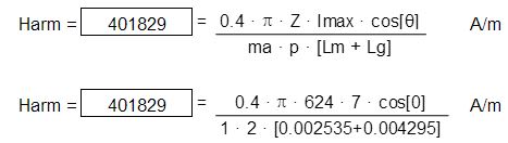

This is from ExcelCalcs . . . However, it does not automatically update as you make changes. You have to do it manually. For me, not such a big issue.
