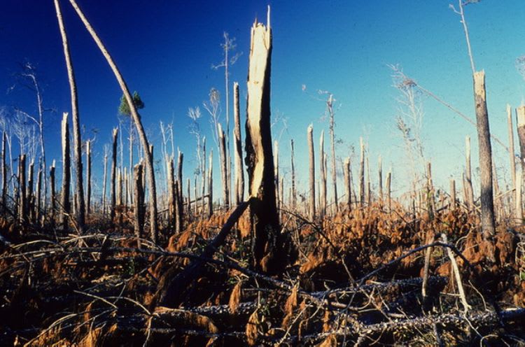

Way too many wide-ranging variables to attempt to make any generalized estimate of the impact loading. Not only would the size, height, distance from pivot point, etc. vary from location to location, but probably the most critical parameter - the velocity at impact, would be impossible to narrow down enough to be useful. Trees felled by the wind are typically pulled up by the roots. I've seen ones that flopped over like they were cut off, and some that rotated 60 degrees and stopped. Most often, they go fairly slowly past 45 degrees, before they start to really 'fall'.

... or large scale shearing of tree trunks above ground by hurricane winds:
