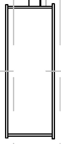

Hello,
Where can I find how to estimate the welds sizes to built-up a box from independent plates?
Those welds will be fillets over small extensions of the larger plate.
The members is supporting axial bending and torsional loads.
I haven't seen a shear flow for torsional or an example.
Thank you.

Lateral Plates: 15"x0.75"
Up/down plates: 6"x0.5"
Pr 177.392k
Mr33 2721.272k-f
Mr22 0
Vr2 8.278k
Vr3 0
Tr 14.51k-f
I am clear about how to bring the moments such as tension and compression to the flanges and the shears to the corresponding webs, but the torsion? They are opposite shears, and how are they distributed if the plates have different widths and thicknesses? And finally how given them to the line of weld?
Thank you.

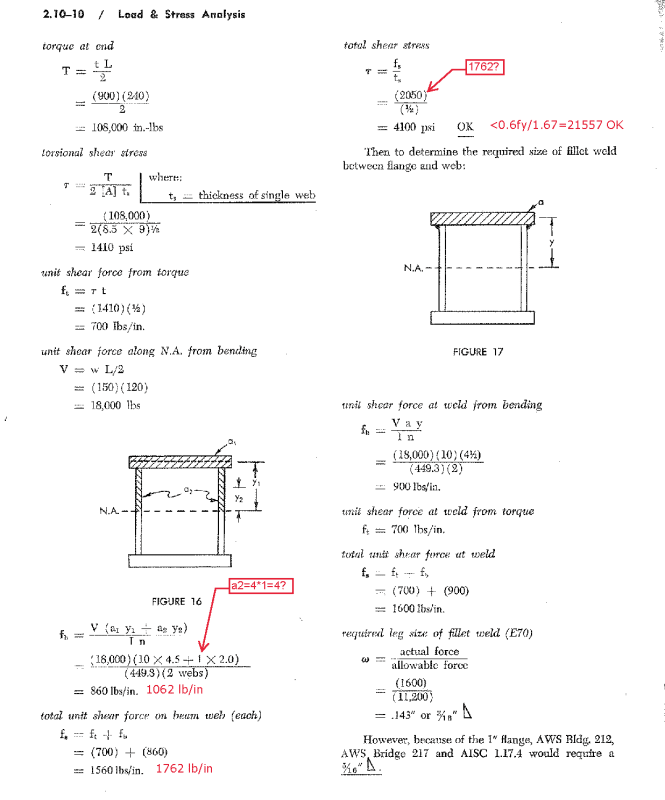

I followed example 5 similar to what I needed, but I found some calculation mistakes.
Can someone look at the correction to see if it is correct?
Thank you.
Thank you, Lomarandil.
I've choked on this myself before. The theory is so dirt simple that I tricked myself into thinking that it must be harder that it was.
Basically, you just multiply the St.Venant shear stress on the red section by the thickness of the cross section there. That becomes the torsional shear flow for use in weld design in exactly the same way that it does when considering the connection between a wide flange beam flange and its web (Mc/I). Easy peasy. And intermittent welding is fine.
