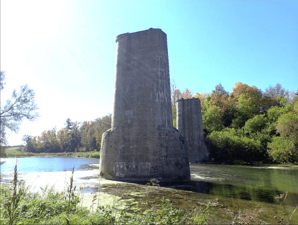

We are looking into rehabilitating piers of an abandoned rail bridge so that a pedestrian bridge can be installed.
There are no drawings available for the piers. There seems to be no reinforcement in the pier as concrete cover measuring device was not able to detect any rebar.

I have added photos taken in summer and in winter.
@ BridgeSmith: It is likely that the piers are not reinforced. However, we were told that in old days, they would place some rails vertically inside the pier. If that is the case, then the pier would certainly have significant strength in bending due to lateral load. Moreover, it was also a practice to provide some horizontal rail grillage in order to distribute the concentrated load on top of the pier.
Since we do not have any drawings, we are wondering if such "reinforcements" are provided. That's why I am looking for old pier drawings if anyone has any.
@ LittleInch: That's interesting! We are not sure if there is masonry in the core.
@ bugbus: There is no deck left unfortunately. The height (15.0 m) is also too much to implement the solution that worked for you. Currently, the idea is to chip some (say 100 mm) existing concrete, and then reface with some (say 200 mm) shotcrete or conventional reinforced concrete.
The river freezes in winter. There are some rebars visible at the nosing / cutwater / flared bottom. So likely the pier bottom can withstand ice load or flooding as it has been doing so for probably a century. But the vertical shaft probably has no conventional reinforcement .
The pedestrian bridge will definitely exert a much smaller load than a train.
Please let me know if you are aware of an old practice of putting rails inside a pier as means of reinforcement.

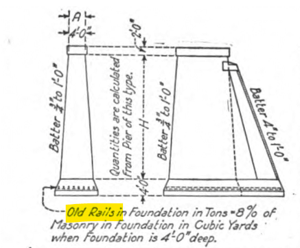

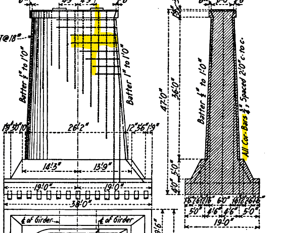

1923+, a time of transition. Go back not to many years, likely unreinforced. 1923, could be either reinforced... or not. Here is a "general arrangement" drawing from a 1924 structural engineering handbook. Reinforced (sort of) with 3/4" bars at 2 feet on center:
The entire section of this 1924 book on railway abutment / pier design is attached.
Rails were typically used as horizontal reinforcement for the pile cap or footing, not vertically.

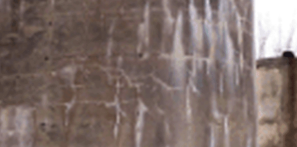

On another aspect of the project, your photos appear to show "alkali silica reaction". Suggest you investigate, design may have to compensate:

One drawing of the uploaded handbook does show placing old rails horizontally at the bottom. But there are no vertical rails or reinforcements in the shaft.
But the Illinois Bridge does show a grillage of rebars (3/4 inch @ 2') in the shaft. I don't know what a Cor. bar is, but looks like its purpose is to confine the concrete core.

Another book I checked out is the first edition (1914) edition of the same 1924 handbook posted earlier (third edition). The section of the 1914 book on "abutments and piers" shows the same, or very similar, drawing of a reinforced concrete pier. IMHO, the change from masonry to concrete must have started shortly after turn of the century.

The white substance on the pier is likely due to efflorescence (deposit of leached out salt) of concrete. But the cracks may very well be due to alkali-aggregate reaction.

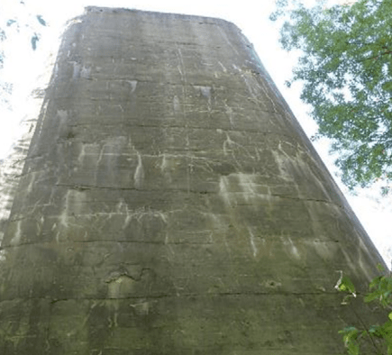

Another photo is attached. There seem to be parallel horizontal lines in concrete. This could be demarcation of each lift of concrete. But it could potentially indicate planes of separation.

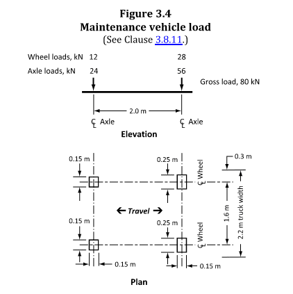

Yes, there will be a maintenance vehicle load in addition too the pedestrian load.
Canadian maintenance vehicle loading looks like the following
