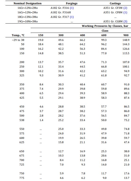

Ikramullah,
what table are you using?
Table 2-2.2 which is the only one with A351 Gr CF8M, has your 2.8 bar at 500C, not 750. The class 150 column stops at 538.
There is also a note saying CF*M needs to be carbon >0.04% above 538
So I don't understand how the vendor is claiming 2.8 bar at 750C??
I also don't understand why he's nickel and diming here for the cost difference between class 15 and class 300 valve...

Then it's up to you.
Basically they are saying the valve itself is good for 1.4 bar at 750C, but the flanges aren't....
