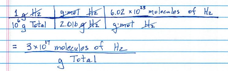

Hello,
I am struggling when trying to convert 1wppm of H2 into another unit (that is the concentration of hydrogen I receive).
I've found some information about ppm, but I'm not sure how to do the wppm (weight parts per million I assume) conversion.
Thanks in advance

Ander Azpi,
I recommend you Google "how to do unit conversions", and. then, research/study a while.
I like to put everything on one vertical line. I've also heard it called "train tracks". Take a look:
Notice, if you want to get to per unit volume ( /m3), you'll need some more information about the total mixture, like a density.
Good Luck,
