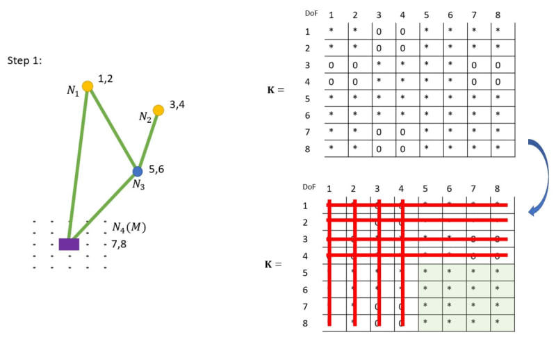

Hi all,
Right now I'm working on a mechanical mechanism where nodes are connected via "spring beams". This is very comparable of doing planar truss analysis, but now the deformations are large compared to the system.
In my analysis, one of the nodes undergoes a predefined deformation, and the rest of the free nodes are moving accordingly, which is calculated via the well known {f} = [K]{d}, where K is the global system stiffness matrix, and d is the displacement vector. Hereby: [K] = [T]^T [K_loc] [T]
When all displacements are known, {f} = [K]{d} is used again to calculate all corresponding forces. I'm interested in the force needed (in x,y-direction) of the node which got the predefined deformation. Because the deformations are relatively high, this process is done incrementally.

In this example, we can neglect the iterative process. Now, we only deal with one iteration (one step in the grid to the right).
In the first step, the global system stiffness matrix is determined. The relevant part is used to calculate the displacements of the free nodes when the purple node is displacement one "gridpoint" to the right:

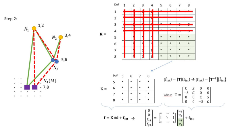

Now, I'm able to calculate for the displacement of the free nodes, for which the pretension (f_int) is included:
Now I'm able to calculate for all forces: for the fixed nodes as well as for the purple node. The latter is of interest.
Part of using the F = k u Equation is a mandatory step where you set the constraints.
You can constrain the system by for example setting deformation degrees of freed deformation to zero inside the U vector.
The next step is remove the rows and columns corresponding to those 'zero' displacements from the entire matrix system of equations, a step one could call sub-partitioning.
Well it is a common problem (at least in structural analysis) to have a prescribed initial displacement at a support, and then to determine the resulting forces on the constrained DOFs.
You solve this problem is basically the same way as if the constraint deformation was equal to zero.
I would look towards a matrix solution for a beam or truss that includes support settlement as a good starting point for your problem.

So in fact I measure the force (in x,y-direction) at the purple node (N4) to hold the mechanism at that specific place (this is what I'm interested in). With pre-tensioning, the location of N4 does not change, but the location of N3 can change (due to the pretension), because that's the only free node in this mechanism.
After I applied the pretension, I shift N4 one gridpoint to the right. Again, the motion of this node is predefined and won't change if the beams would have other stiffnesses/prestress. The only thing I'm interested in is what force is needed (at N4) to displace the mechanism as such.
In short, I measure what force is needed (in x,y-direction) to have that purple node (N4) at every point on the grid. This works well without pre-tensioning the beams, but the results seem weird if a add a pretension the way I do it now.

You're looking for the force to move N4 form 1 point to any other of your 25 points ?
if I understand you right, then statically (with zero load) N4 is somewhere away from your starting position (at 0,0, yes?)
let's say that statically N4 is at (1,0) ... so you apply a force in the -ve X direction to get N4 at (0,0) ... yes?
now if you apply some other force to N4 and it moves, then the internal loads will be just the sum of the two moves, the sum of the forces applied to N4.
as a load I don't like enforced displacements, and would rather apply X or Y loads to N4, to determine how N4 moves (non-linearly), then fit these movements into your grid.
