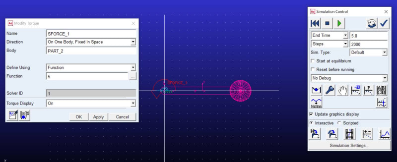

Hello everyone, I apologize for using this platform to ask my question. In Adams software, I am currently working on a simulation where I am applying a constant torque to a link that behaves like a pendulum. The system has no other forces acting on it, such as gravity or friction. According to the formula T=I*alpha, the relative angular acceleration should remain constant throughout the simulation. However, I have observed that in some instances, the acceleration becomes zero while in others it continues to increase.
I am seeking advice on how to obtain accurate and consistent results in my simulation. Any suggestions or recommendations would be greatly appreciated.

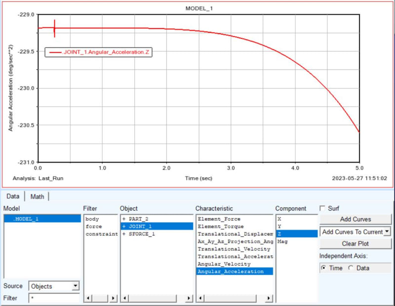

As you can see the Angular Acceleration changed. I try all measures (from torques, body and joint) all results is same, also i create an angle measure an derivates it, the result is same.

To simplify the model, I have inserted a point mass body in the end of the link, which has a spherical shape. This ensures that the moments of inertia along the x, y, and z axes (I_xx, I_yy, and I_zz) are zero. Even if these values were not zero, the same problem would still exist. The length of the body is 0.5 meters and it has a mass of 5 kilograms. Therefore, the inertia that affects the joint is given by the formula md^2 = 5*0.5^2 = 1.25. The torque is 5 units, which can be used to calculate the angular acceleration using the formula (alpha = T/I) 5/1.25 = 4 rad/s^2. In degrees, this is equivalent to 4*180/pi = 229.183 deg/s^2. Initially, these results provide the correct answer, but the angular acceleration changed!

The gravity was not considered in the model, and no other forces were included aside from torque. Although the formula is correct (you can check it, or determine it with Lagrangian method), I need to validate the simulation for my main model - the RRR manipulator. However, since the results obtained from the simple pendulum are inconclusive, I cannot proceed with controlling the robot until I am able to validate the simulation using the RRR manipulator.
torque is 5 Nm and link is rigid, (if you asking for flexibility it's not.)

Have a look at the magnitude of the acceleration, you may find you have chosen a marker that is moving. As you can see there is unexpected behavior at t=0.2

It appears to me what I would expect if the weight is not constrained to a fixed radius and the radius changes with angular velocity. It's poor practice to examine only one variable when a model is misbehaving. You should have plotted angle, angular velocity, applied torque, and radius to the mass to ensure that everything you thought was fixed remained fixed during the simulation.

Your plot shows (as I see it) that some angular momentum is being "lost" (or not accounted for in the plot). Did you figure this out ?
