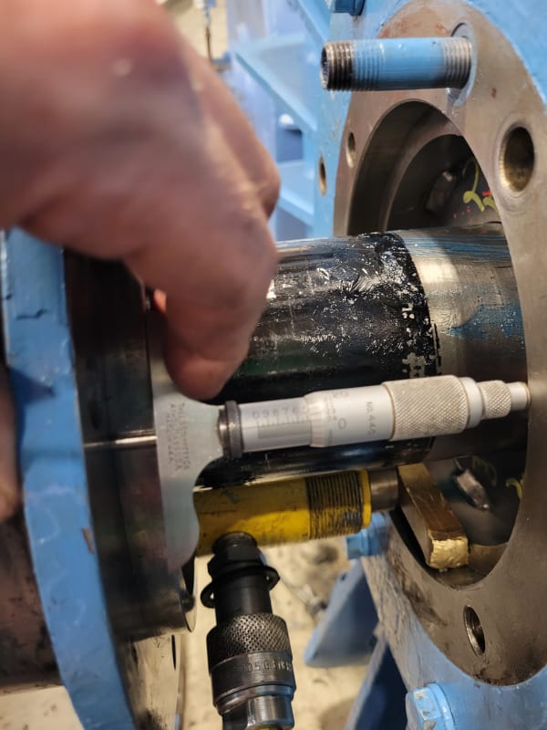

Good Day. We recently received our 1MW motor back from a re-bearing job. The DE bearing burnt up due to a lack of lubrication. It is a double spherical roller bearing that is lubricated through a port on a center groove machined into the periphery of the race. To me at least, it looked as though this bearing was insufficiently packed when it was overhauled last time in 2019. It had intermittent use since then. After investigating the failure, it seemed as though the grease port was also blocked, so it was a double whammy for that bearing. At any rate, we reinstalled the motor to a gearbox last week and were surprised to find our vibration monitor lighting up like a Christmas tree, with axial vibration being the highest. We had an outside expert come in to do some vibration analysis with some higher end gear than we had at our disposal, and he pointed to the gearbox as being the problem. Tear-down revealed nothing more than one worn thrust face. There was also some wear on the far side of the driven exhauster bearing. I am thinking that the motor may not have found its magnetic center before coupling up and there were severe thrust loads put into the gearbox causing the wiping of the thrust face.
Here is the kicker though. When the motor was installed, it became clear that during initial installation, there was so little clearance between the motor mounting holes and the bolts, that one bolt had to be machined in order to get it to pass through the hole. This severely limits the ability to set the motor in any position other than where it is. It has operated like this for decades, so I doubt this has caused the issue. The shafts were laser aligned with a PrufTeknic (sp) Rotalign and there was smiley faces all around.
The motor and gearbox are coupled by a large solid machined pair of hubs with 14 drive pins. The hubs are about 16" o.d., and complete with pins the whole assembly is estimated to be around 440lbs. We noticed that some replacement pins that were fabricated in house weight as much as 10grams less than the older pins. There were also 2 different types of lock nuts on the pins which varied by 5 grams. I do not think that these could be responsible for the vibration issues given the low speeds and weight of the hub. i would like to replace these with a grid coupling, since they are time consuming to link up. I am not sure how tolerant grid couplings are of thrust loads however. The balance condition of these hubs are also unknown. This is a mid 30s era machine, taken as war booty after the WWII. It was apparently installed at the the V2 works.
I noticed during the installation of the coupling drive pins that I was able to insert a large pry bar between the face of the drive and driven hub and move the rotor about 5/16" of an inch axially away from the D.E.. This seems excessive to me. The axial travel of the rotor away from the drive end seems constrained by the D.E. bearing bottoming out in its housing, but the axial travel towards the D.E. seems to be constrained by nothing bu the pins, or the hub faces, which is to say, the inward travel of the N.D.E. bearing has not bottomed out in its housing. i hope that is not too confusing.
The motor was converted from sleeve bearings to roller bearings in about the mid 90s. On the new end covers, the end caps of the bearing housings have an inner lip or "spigot" that I assumed set the position of the bearings, and hence, the shaft in the motor. Upon further inspection, the NDE bearing race of the identical second stage exhauster motor in the train had a gap of about 1/8" of an inch to the raised spigot ring, while the NDE bearing of the repaired motor had a gap of about 1 3/4" between the bearing race and the spigot ring. I honestly don't see what if anything is keeping this rotor from walking axially. The bearings are secured to the shaft with a locking nut and lock washer, and when the rotor is moved manually the whole bearing slides inside the end cover. The repair shop said if the bearing O.D. is on the small side of tolerance, it can have enough give to move in the case. I do not have the expertise to contradict this, but even in small motors there is usually a wave washer of some kind to help keep the rotor where it needs to be.

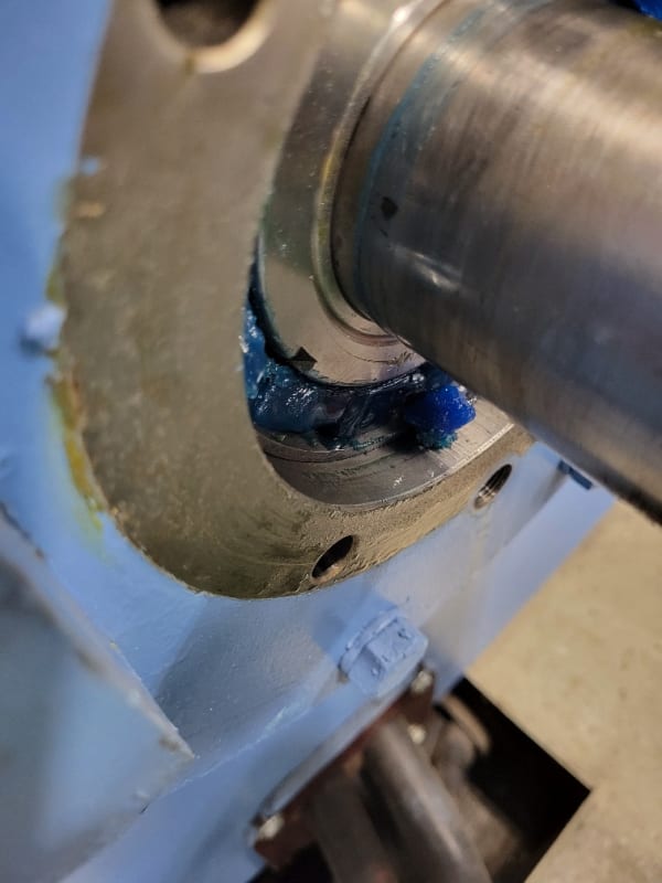

This is the detail of the D.E. of the motor with the failed bearing. This is actually the bearing in question. As you can see, there is a locating piece behind the bearing cap which positions this bearing in place. This piece was able to be slid out by hand and I inspected the failed D.E. bearing directly behind it. The gap to the face of the piece, and the bearing end cover spigot seem to be locating this bearing in place.
This is the detail of the N.D.E. bearing on the second stage motor which did not fail. As you can see, the bearing race is quite close to the end cover face. The bearing cap has a locating ring on the inside face. You can just see a tide mark between the bearing face and the spigot ring, which is about 1/8" of clearance. This seem reasonable to me to allow this bearing to move outward as the motor heats up in use.
This is the N.D.E. bearing of the motor which experienced the bearing failure. The gap between the bearing race and the end cover is about 1 3/4". The spigot ring on this end cover only goes into the bore about 1/2", so there is no way on earth it will limit any travel of the rotor. I can physically move the motor rotor with a pry bar and this whole N.D.E. bearing will move in and out about 5/16". It does not seem correct.

Thank you everyone. First let me clarify a mistake I have made. The shaft end clearances are about 5/16", the total end float of the rotor is about .110". This is still in sharp contrast to the second motor coupler which exhibits zero float in the exact same configuration. I cannot move that rotor at all.
After calling in some expertise from a large millwright/electric motor/generator repair facility south of the city, we have come up with following plan of action:
Drive the shaft into the motor as far as it will travel so the D.E. bearing is fully seated into its bore. Remove the end cover and distance piece, and measure the distance from the motor end face. Add the distance piece length and end cover spigot together and make and install a split ring to take up the excess clearance, minus a few thou to prevent crushing against the bearing race when it is closed up. This will fix the D.E. bearing in place and leave the NDE bearing to float for thermal growth.
While the distance piece is out, we can check for something weird like a loose lock nut. I doubt this, but never say never. The fact that I can easily move the shaft shows me something is wrong in the d.e.. Either the shaft is slipping through the bearing, or the bearing is sliding inside the motor end cover. Either way it has to be corrected and fixed in place.
For the gearbox input shaft thrust bearing, the thrust ring has worn a circular path on the babbitt face of about .010" to .020" deep. The proposed method to deal with this is to machine the face flat again, and shim the entire steel bearing housing forward to take up the slack. There are removable brass pads with shims on them on the outside faces of the housing that can allow the bearing to be positioned within the groove in the case it sits in.There is still a good thick layer of babbitt on the thrust face, with no cracks or delamination evident. I opined that the bearing carrier looked symmetrical and perhaps we could just turn it around and use the undamaged rear thrust face, but we all agreed that was a bit too back woods engineering without proper drawings and too big of a chance to take. If the steps we take can solve the issue and get us back within acceptable vibration limits, it will be a win for now. Once we have a more open schedule we can get these bearings rebuilt.
The motor guys were a bit lukewarm on the grid coupler. They suggested a twin disc arrangement. We agreed that tight drive pins may be an important component of the problem. The couplers have been doing their thing for 90 years now though, so its probably more of a problem of setup than of the technology itself.
So the motor DE locating bearing was not properly located in the housing just as I suspected?
A correctly sized split ring (axial clearance + one thou) that will press the DE bearing outer race positively by one thou from the front end is needed. And the coupling bolts should have that extra bit of length since the coupling will now move away from the original position by whatever the axial movement you measure.

I took awhile to get there but my final edit (edit3) also suggested a comparison between the two motors to distinguish between two competing scenarios. That's something similar to what Bill suggested, but he didn't need as much rambling to get there.
I removed the front cover, pulled the couplings together to get the spacer ring out far enough to pull out by hand to measure the o.d., then I reinstalled it and bottomed out the ring and bearing in its bore with an Enerpac, until I just felt resistance in the lever. This is probably a more accurate and consistent method than a pry bar.
The end cover face to the spacer ring face distance was 0.715". The spigot ring is 0.453", so there is around .250"-.260" of float in the d.e. bearing. I am giving a range since I doubt the ring was sitting completely flush all around. Sorry for all of the conflicting measurements, but this is really the first methodical approach to seating this bearing.
I watched as I moved the shaft with the pry bar, and the bearing and locking ring are firmly attached and moving with the shaft. So, it seems we need to manufacture a spacer for this end to take up the slack while leaving a bit of room to avoid putting any crush on the race. This leaves me with a couple of questions;
1) Has this bearing always had this much play?
2) Is it now only evident because we happened to hit on a bearing on the low end of it's o.d. tolerance, and most importantly,
3) Does this affect the alignment of the outer bearing lubrication groove with the grease port in the end cover? This is a biggie, since lubrication failure of this bearing started this whole mess. It could not have happened at a worse time, as we are on the cusp of a very important test.
As for rotation, if you look at the motor in the first picture, it would be turning clockwise on the d.e..
The wear on the thrust bearing is on the face towards the motor, so it is as if there was significant thrust being imparted to the gearbox from the motor.
The shaft end gap has now increased appreciably as you might well imagine. We will have to approach the pin installation very carefully. There is a chance of applying high clamping loads on the hubs if we run out of clearance before the nuts have bottomed out on the threaded ends. Some of the heavy washers on the pin ends are heavily dished, so this may have been an issue in the past.
We have to eliminate the assembly stresses from tight pins as well. I am wondering how much this machine might have been has been fighting its own setup.
Feel free to critique my methodology and proposed solutions.
Thanks!
