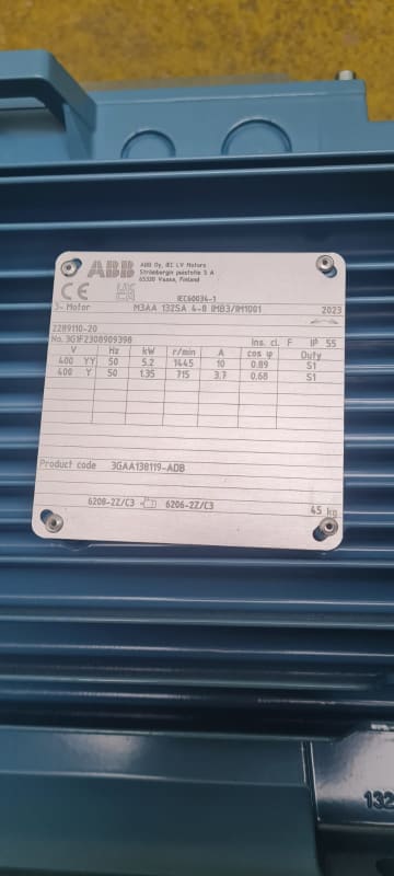

Hi All - the original motor was not returned by the company who replaced the motors that were installed and burnt out in high speed after a few hours- Below is the original drawing of control circuits and the new motor plate - talking with the person who has connected the new motor which is running hot 🥵- we are not sure if this new motor is correct as reading above we would need to run 3 Contactors due to it being one winding two speed with 3 contactors
We have put clamp meter and motors pulling 12.5 Amps at high speed was feedback off electrician
Wba - Yup, the old motors were two winding two speed and hence only two contactors.
Don't know how your electrician connected the new ABB one winding two speed motors with only two contactors, unless he was manually fixing and removing the 1U1V1W short for each speed.
And yes, your motor is definitely under powered if your current is correctly measured as 12.5 A. You need to go in for 7.5 KW motors to handle 12.5 Amps (if that is the true value measured) with a safety cushion. For the same centrifugal fan, power (or amps drawn) is proportional to the cube of the fan rotational speed.
Best to go back to the original two winding two speed but with higher KW rating that meets your load currents at both speeds. May be a bit more expensive but less complications.

Your electrician probably connected the new motor (pictured on the right) with only 2 contactors.
The motor will operate normally at low speed under these circumstances. However, at high speed, it will rotate but will be heavily overloaded and hot because it lacks an external wye connection and motor works with half of winding.

Mr. Wba1 (Electrical)(OP)23 May 23 16:01
"....#1.- we have two cooling tower motors that have both burnt out in the last 12 months- we send them usually to be rewound and come back connect back up with no problems-.....#2. the contract changed and the motors were replaced by two speed abb motors and old motors not rewound - we only use two Contactors for high and low speed - the motors were connected and both burnt out. It’s a 6 point connection remotely to a control panel with two contactors - wondering if the motors are correct to use ?"
I am of the opinion that :
1. the original drawing showing Lo-speed 1.1kW Hi-speed 5.5kW with ONE contactor of Lo-speed and another ONE contactor for Hi-speed is an error? One contactor for Lo-speed and another contactor for Hi-speed is only suitable for TWO separate windings two-speed motor. Unless special request, a P:5P (W) , N:2N (rpm) motors usually for FAN load are manufactured in DAHLANDER YY/Y connection; which required THREE contactors and TWO overloads.
2. The new motor is a standard IEC motor with Dahlander YY/Y winding.
3. Revise your control circuitry to THREE contactors with TWO overloads according to the Dahlander motor wiring diagram.
